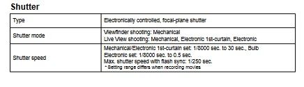

Your best bet is the Advanced User Manual, not YouTube videos.
Electronic shutter is only available in LiveView:

09-19-2023 04:28 PM

09-19-2023 04:42 PM - edited 09-19-2023 04:43 PM
Get the PDF one.
There is no index, but I searched for "Electronic" which showed me the Shutter mode page in the Live View section, but no equivalent in the mecahnical shutter section. So I went looking for the specs and Bingo!
