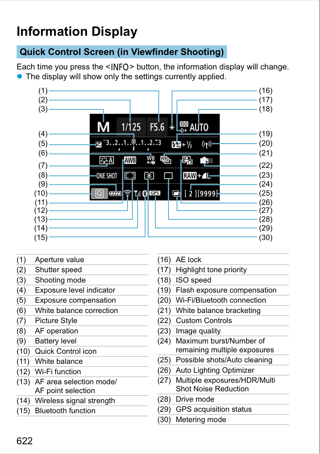

I still think there is nothing really wrong. What is the maximum burst size displayed on th INFO screen, see item 24.
