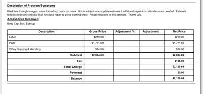

Woof that’s a heavy estimate. Noticed on their interpretation of the issue they note “crack on mirror.” Spoke to a tech just now who had also never heard of this happening, he escalated the issue up the ladder. Will hear back on Monday/Tuesday.

Like others, this is one of the most bizarre things I've ever seen. I might understand if the camera was subjected to severe impact. The CMOS sits on a substantial wafer. Excessive heat is the only other thing I can think of that might cause something like this. Your estimate is hefty. KEH has 1DX2's for $1800~$2900 (bargain~excellent+)
Your options are somewhat limited. R3 (not available). I wouldn't buy a 1DX3 now as it would not be as future proof as the R3 in a year. Estimate is still roughly half as much as a new camera. If Canon does the repair, you have warranty and the assurance of a functioning camera. I'd fix it and plan to upgrade in a year or so.
