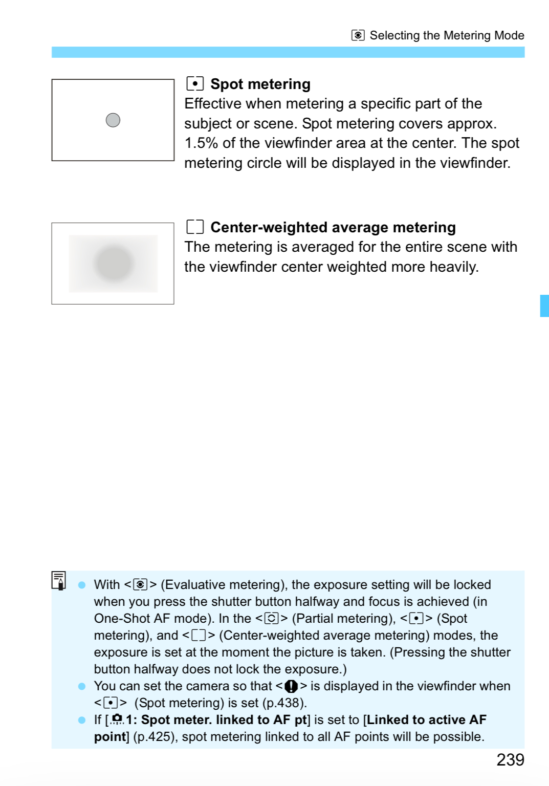

After some searching, I have found the documentation that confirms the behavior that I described. Which was, in One Shot mode the exposure will lock, and stay locked until you release the shutter. In other words, when you use One Shot, the exposure will stay locked for as long as you keep the shutter fully pressed in Continuous Drive mode.
This behavior is described in the blue box at the bottom of the page.
You can learn something every day. Apparently, the exposure lock behavior is dependent upon your metering mode. If you use Evaluative Metering, which I do 99.999% of the time for action photography, then exposure will lock once you perform the initial [focus] lock.
For the other metering modes, [apparently] the exposure does not lock. The camera will meter the exposure for each new frame when you are using Continuous Drive mode. You can learn something new every day.
If you want do not want an exposure lock with Evaluative Metering when you are using One Shot AF with Continuous Drive mode, then follow the approach that I suggested above. Even though the AF mode is AI Servo, you can force the camera to wait until it achieves a focus lock before firing the shutter, just like One Shot AF. But, it meters each [new] frame because it is in AI Servo mode, unlike One Shot AF.
