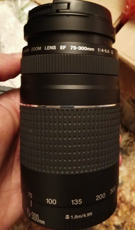

looks like I have one EF and one EF-S.   The EF-S does not fit but the EF does fit.  The EF does not autofocus on the Elan.  I put the EF back on my rebel and it did autofocus so the lens seems fine.    I will look for an elan manual, maybe I am doing something wrong but I think I have all the setting right.
this is the lens i have.

That lens would not be the best choice to use on the Elan unless you have good light. Like outdoors on a sunny day.  If you try it in those conditions I bet it will AF just fine. I will guess the Elan's battery is good and up to the task?  If the battery is weak or not fully charged it might cause the lens not to AF. Check out the battery first.
