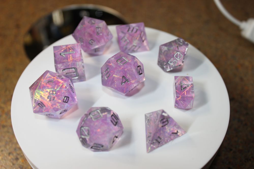

So i make dice, specifically for table top gaming, and i bought the dslr canon t3i to take better pictures of my finished piece sets than i get with my samsung galaxy flip phone. Here is probably the average pic ive taken with my camera so far using the kit lens, tripod, remote trigger, and setting at f16 to get maximum depth of field on aperture priority mode. these settings were recommended to me on reddit, obviously im new to this and reading a lot , what im looking for is much better detail, im working on increasing lighting, etc as well,

The specific lens you have mentioned so far is not known for its image quality -'cheap and cheerful' was one comment I read about it.
Most people buy something like a 'nifty fifty' for its low f/number of around f/1.8, which offers benefits to isolate a subject and allow low-light photography. However, as my colleagues have said, you don't want less dept of field close-up, you want more. Simply put, the higher the f/number - f/8 - f/11 or so, the deeper the depth of field. So, as Mike and Normandel have said, a kit lens from Canon would give you at least as good results.
If you were going to invest in another lens, you want something in the 15-35mm range. If you have one of the lenses: 18-55 or 18-135, that my colleague Normandel mentioned, I would start with that at a short focal length.
Set your camera to Av mode, and the f/stop to f/8 or f/11 and use Auto ISO. The rest of the task comes down to providing enough light from the right direction to give the best showing of your products. You might want to consider some kind of small tripod and use a remote cable or use the built-in timer to avoid camera movement.
11-03-2024 06:33 PM
yeah im using a tripod and remote corded trigger so as not to move the camera, ill tray the settings you mentioned, on reddit i was told to go high like f10 to F16 to get max depth of field in focus as im really not wanting to learn focus stacking. i have almost 2 hundred sets of dice ill be posting up on a site for sale and to knit that many pics together would take me a novice, way too long, lol, thanks for th ehelp. ill just send this one back and try to get better at the kit lens before i think of trying some other lens
11-03-2024 06:44 PM - edited 11-03-2024 06:45 PM
Lose the white backgrounds and kick up the lighting power a bit.
And go full Manual.
11-03-2024 06:47 PM
to be honest ive had to go manual on the focus for sure because the auto focus doesnt seem to like shiny glittery filled things, lol
11-03-2024 06:59 PM
However I am referring to manual exposure.
Letting the camera body determine the shot you want is a guaranteed failure.
Add more light, open the F stop a tad lose all of the reflective backgrounds unrelated to your product and shoot your product like it was a collection of diamonds.
