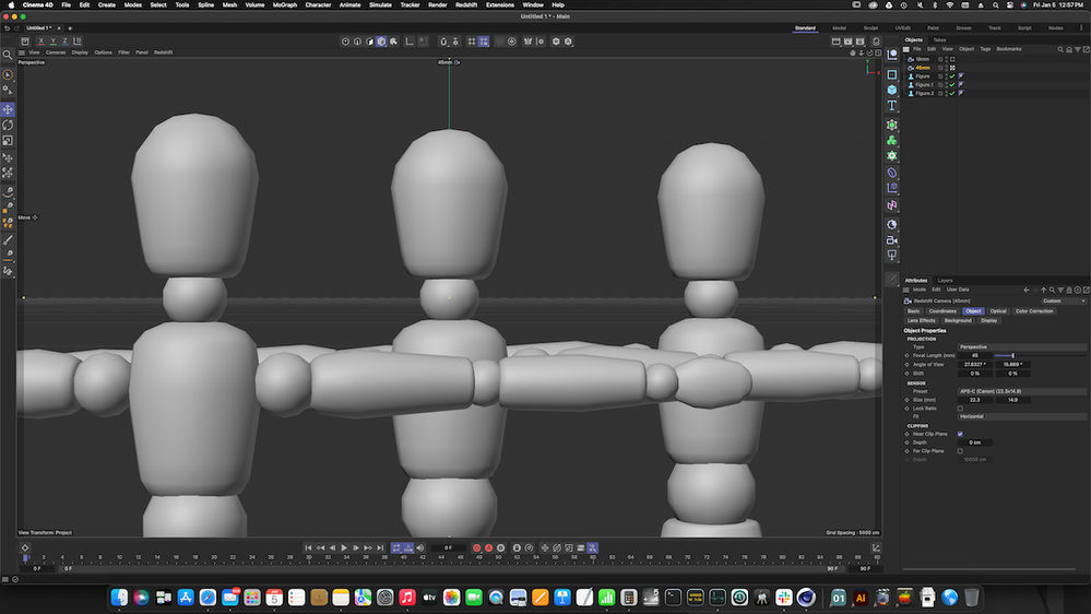

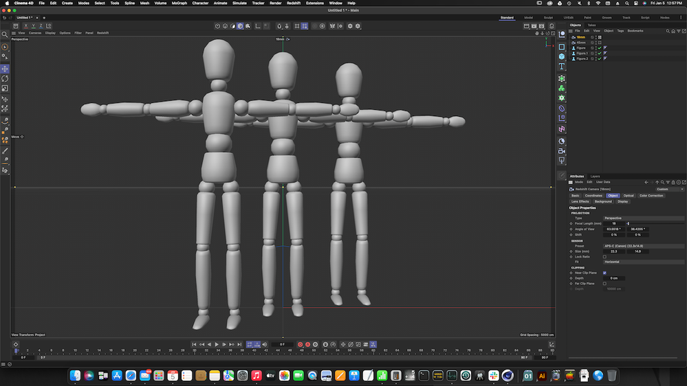

Here are a couple images showing the framing of three people ten feet away from an APS-C sensor camera.  One at 18mm and one at 45mm.  The mannequin figures here are 170cm tall (approx 5'11").
When at 18mm, I had the camera at a height of around 86 cm which reveals you can get full body.  When at 45mm, I had the camera higher to capture heads.
APS-C Simulation 18mmAPS-C Simulation 18mm
APS-C Simulation 45mmAPS-C Simulation 45mm
