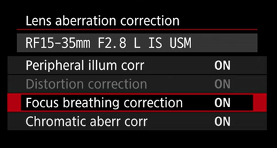

This is good news and helpful.  Its likely the R5 C is going to get Lens Breathing Correction for video in an upcoming update.  I have always used my SD card for updates.  Someone posted yesterday about trying from their CF Express B card on their R5.  Failed until he put it on an SD card.
Unlike the R5 C's update instructions, the lens update doesn't specify an SD card and also states "* Compatible with cameras that supports focus breathing correction."  This made it appear the lenses would simply ignore body's without the feature.  I should have thought to ask if you were using an SD card.  I only assumed you were.  Now we know.  😉
Download and Installation Instructions Firmware Version 1.1.4 incorporates the following enhancement:
1. Adds the ability to correct focus breathing during movie recording.
