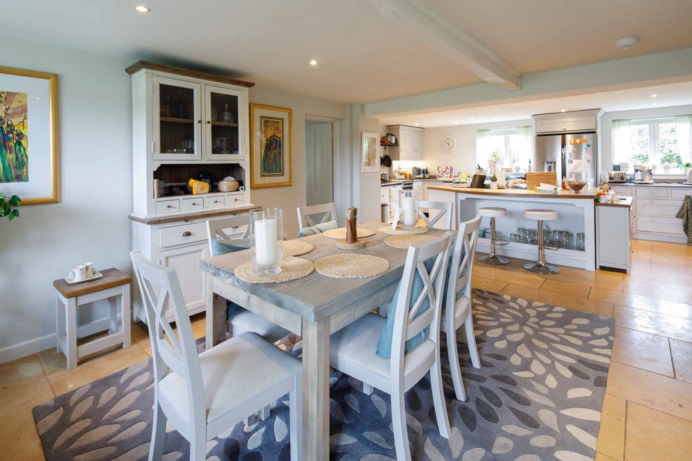

Please look at this image taken with the Canon TS-E 17mm f4 on a Canon EOS 5D MkIV at f7.1 ISO 320 0.3 sec. The lens is shifted down slightly.
If you look at the corners, all look sharp except top right side around the window and coffee machine area
Why is this, and can it be fixed?

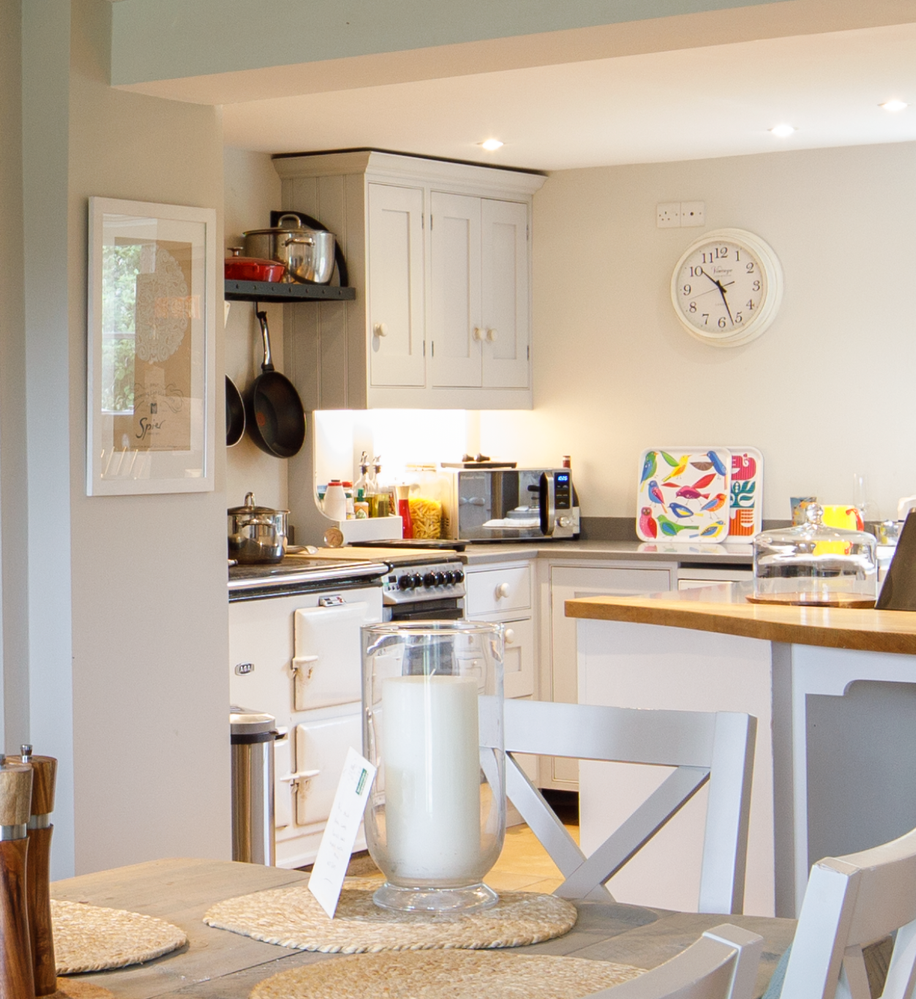

Hello, if you think the image 'is fine' perhaps you cannot see the issue?

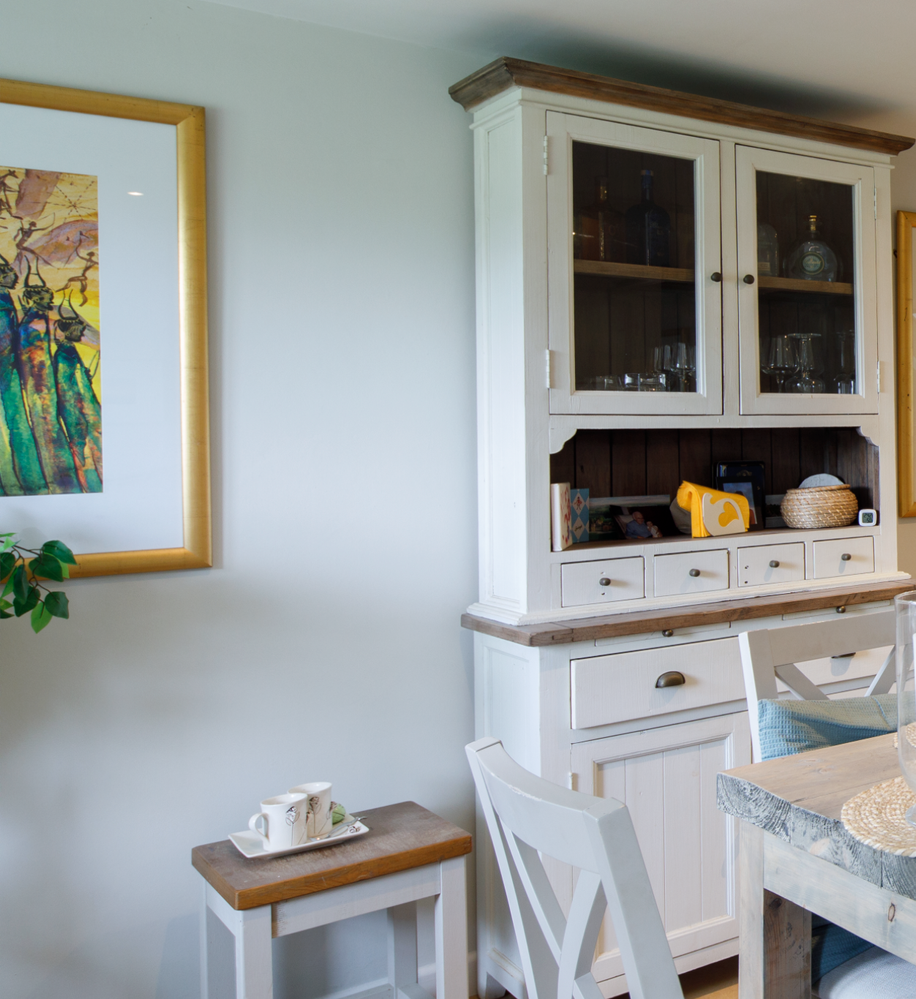

I have attached screen grabs from the left, centre and right side. You can clearly see the blurring on the right side.Left
Centre
Right

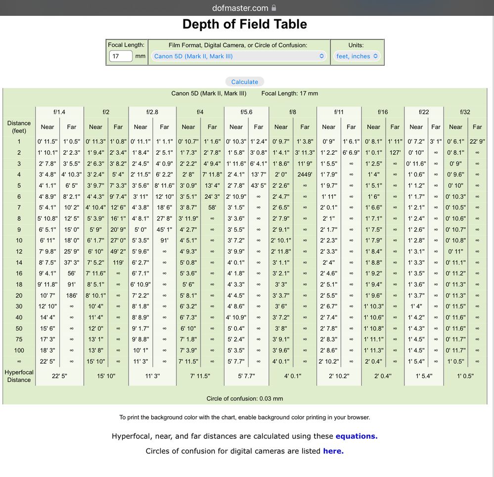

Look at the f/8 column. Your DOF should have been quite deep.

Even though you have tremendous depth of field with a 17mm lens @ f7.1, it looks like your lack of sharpness could be coming from depth of field. It appears to me that as you go from the far left to the center crop that sharpness is already dropping and it becomes more evident further right in the frame. Distance from the camera to the far wall is also increasing as you move to the right in the scene. To my eyes, it looks like the foreground in the far right crop is better than the background in terms of sharpness again indicating depth of field is the issue.
As an experiment, try retaking that scene and focus on part of the scene further removed from the camera. This is going to throw your foreground out of sharp focus but it will be useful to see if the problematic corner now looks sharp which would indicate it is a DoF rather than lens issue.
A 17mm lens @ f7.1 with the focus optimized on a point 3 feet from the lens has a depth of field of about 6' with limits of 2 feet close and 8 feet distant in critical focus, choose the critical focus point 7 feet from the camera and everything from 3 feet to infinity should be in critical focus. You may need to either decrease aperture or if possible move the camera further away so that the closest item in the photo is not so near allowing the critical focus point to be chosen where all of the relevant scene is within the critical focus depth of field.

Thanks for the reply. I did as you suggested, moved the focus further into the subject and the issue appears to have gone away.
