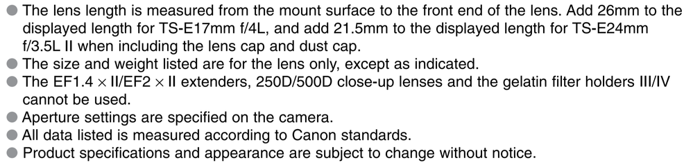

This is straight from the manual. The TS-E 17mm F/4L IS NOT COMPATIBLE with any of Canon's teleconverters. All of their TS-E lenses are INCOMPATIBLE.
-Demetrius

The manual for the lens clearly states that the combination you're trying to use. IS NOT compatible and you should not attempt to use it. Will the lens work without the teleconverter attached. Just with the Canon mount adapter and the TS-E lens.
-Demetrius
