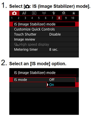

I reviewed the R10's manual.  It states that the IS menu option appears when an attached lens doesn't have an IS switch.  Note that the [IS mode] setting is not displayed when you are using IS lenses that have an IS switch.
Movie Digital IS:

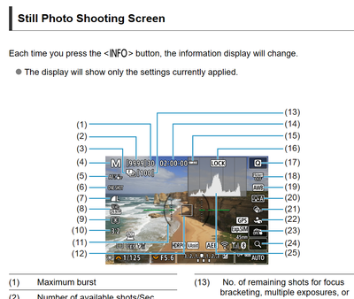

Still Image Informational Display - No IS icon reference
Digital Movie IS - Has "Hand Icon" [8]
The hand is not referenced for stills mode, but we know its there if you enable IS.  Please try cycling the [Info] button.
