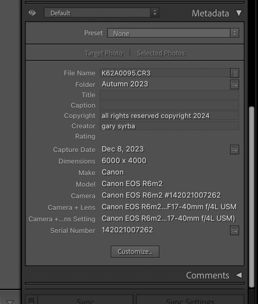

I have the R6 Mk ll, and like you, I love my old lenses - many that go back to the 1960's. I do know that the more recent EF lenses will show up in the EXIF data, such as my EF 17-40mm F/4L from 2003, as you can see in the screenshot here. Yes, my in-body IS works fine with this lens.
