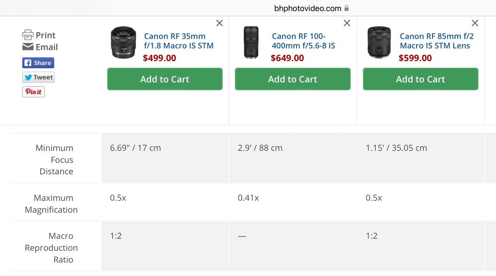

If you are interested in photographing flowers and things, then a macro lens can be useful but not absolutely necessary. This comparison chart compares the “magnification factor” of the lenses you cited, plus one more.
The magnification factors of these lenses are pretty close to one another. You may notice that the two lenses actually labeled as “macro” have magnification factors of 50%, which is typically the minimum amount you will see for a true macro lens.
These three lenses are capable capturing near identical images of a rose. One lens is not capable of significantly zooming in on the rose compared to the others.
The main difference between the lenses will the working distance between camera/lens and the subject. The MFD, or Minimum Focusing Distance, is measured from the image sensor, not from the front of the lens.
