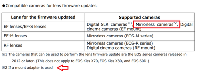

I had seen in another post about a firmware update for the EF 100-400mm f/4.5-5.6L IS II USM (which I discovered the previous 1.0.6 version on mine). I hope this isn't a dumb question but can I do the update via an RF to EF adapter on my R5 or R6ii?

Excellent. I did 3 lenses last night and actually reviewed the update procedure. It does change depending on your hardware. I noted this. ➡️ OK to use supported mirrorless body to upgrade EF glass with EF to R adapter.
