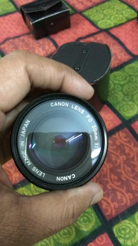

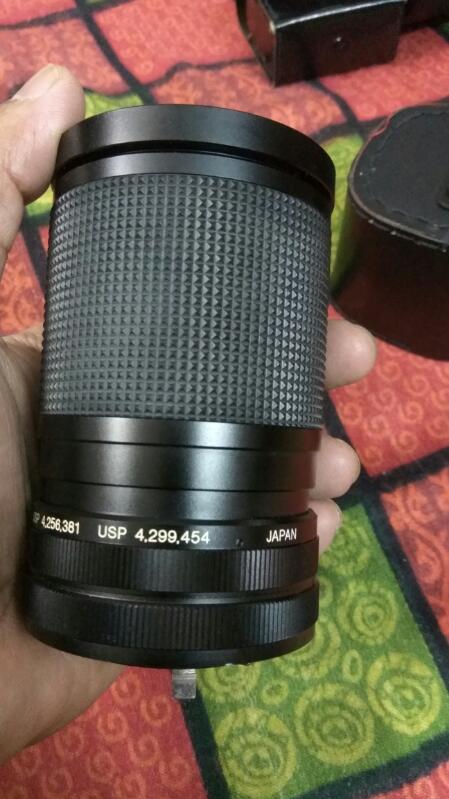

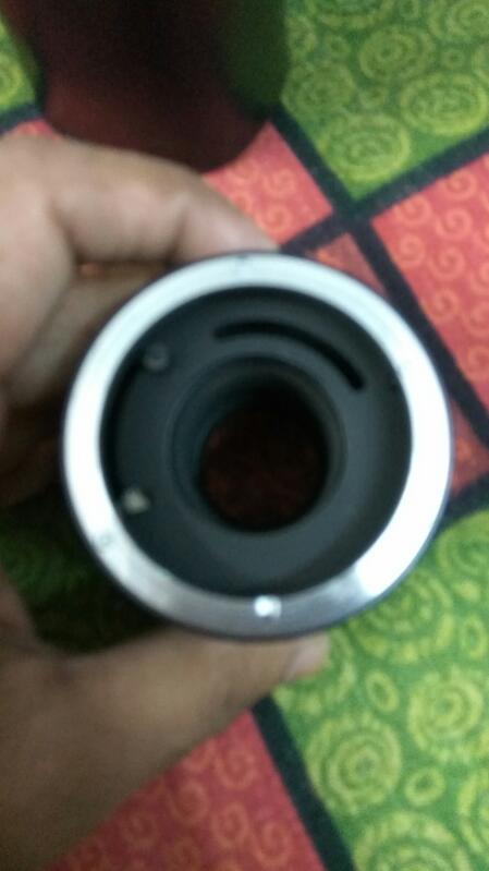

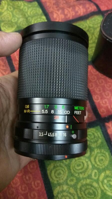

Recently got the Vivitar FD lenses of canon T70 (of year 1984 ) and wants to use them with new technology DSLR's so looking for mounts for them.
Please help/share links of mounts which can be used them OR if they can be used any of new Canon directly.
Thanks in advance.

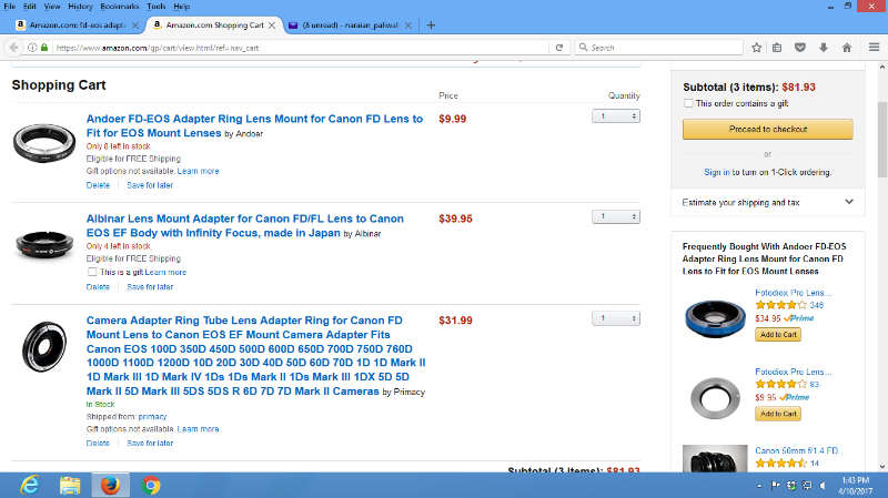

Agree and had in mind that it would not be worth to spend more on these lenses but I am  on budget and as a beginner I want to use them as of now.
as suggested I have seen few of them on amazon, price difference a lot so could you please suggest or share the perfect fit for me.
I am not willing to give any advice. As you you can tell, we have little experience with them.
"...but I am  on budget and as a beginner..."
All the more of a reason to not try and do this.  It is a bad idea all the way around. Smiley Sad
However, knowing you will most likely not heed the advice from several of us, the Ed Mika adapter is the best. I have tried a lot of the so-called adapters and wasted a lot of time and money but you do as you see fit.  You will have to google Ed Mika adapters as the moderators will not allow me to show you.

You may want to research Ebay for Ed Mikka adapters.
 His adapters are for Canon FD lens. You modify the back of the lens and replace the FD mount with EF mount adapter.
They were selling for about $75.00 each.
You can visit Youtube on how easy it is to change mounts.
Most Important, there is no cheap piece of glass used because Ed Mikka has made his adapter the exact distance necessary for focusing the entire lens design.
