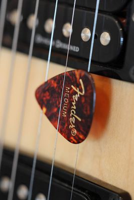

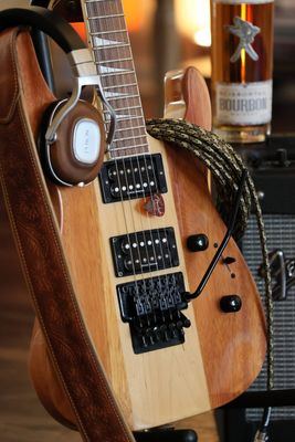

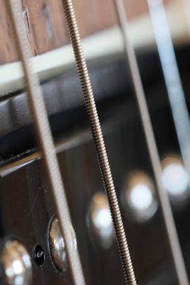

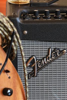

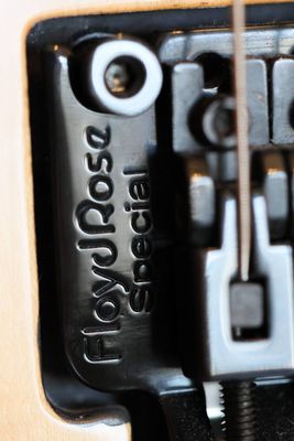

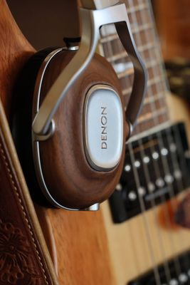

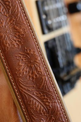

No experience with nails but if you're looking for a lens with buttery background blur and a tight focal distance so you could get right into your brush and bottle I'd recommend the RF100mm Macro 2.8.  It's not a zoom so may not be practical but it's a fantastic tight in macro and at 100mm you should be able to mount it far enough away that you could easily work under it.
It's not cheap so you might want to rent it once to double check the working distances for what you need but I think you'd be pleasantly surprised with the stellar focus and creamy look.
I've attached some guitar pics I took that demonstrate getting tight in as well as a good distance away.  These pics are unedited JPG right out of an R7 and the color is remarkable so you can be confident the nail colors you shoot would pop nicely.
