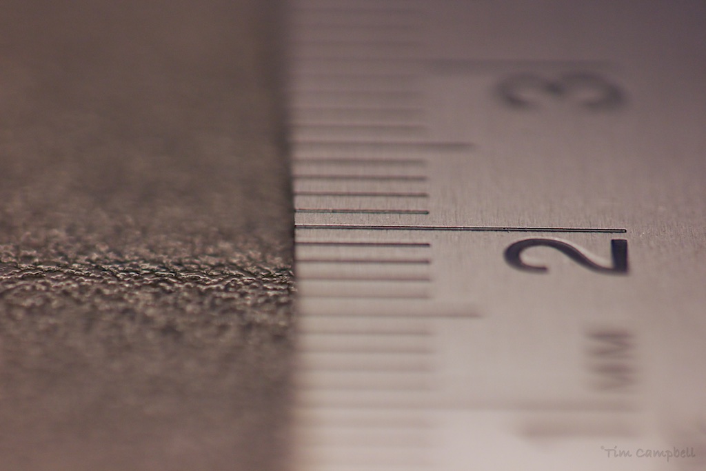

Here's an example:
Notice here how the depth of field is barely over 1mm thick (this was shot using a 100mm macro lens). This means that you're likely to stop down to a much higher f-stop to get everything in focus. But THAT means collecting less light through a tiny aperture and THAT means you may need a longer exposure time. This can be a problem if your subject is an insect (which tends to not sit still) or even a flower outside if the wind is gently blowing.
