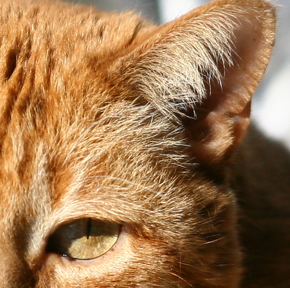

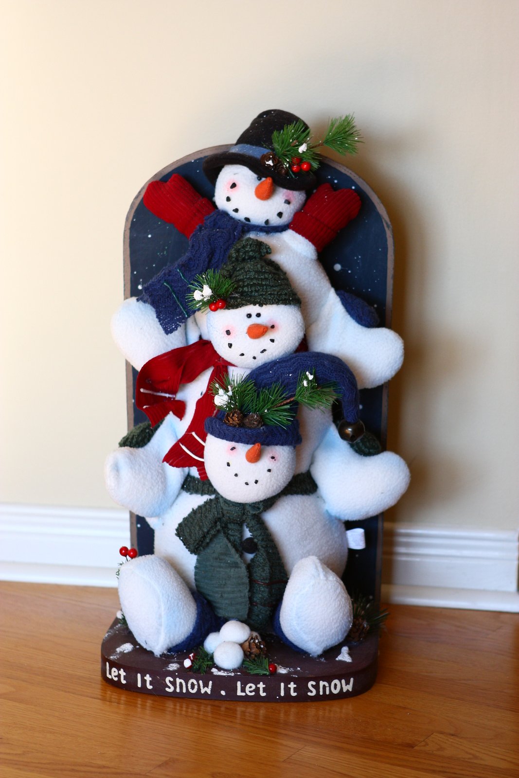

I happen to have owned both the 28-75 & the 24-70  & have full file samples on line, and they can be downloaded to evaluate but unfortunately they aren't from the same camera nor are they of an identical target. These shots are low res full frame followed by what would be a 100% crop if it displays here at about 600 pixels X 600 pixels. Both samples were shot wide open at f2.8.
Images shot with the Tamron start here & using the Right arrow will advance you through the set.
http://picasaweb.google.com/116179596240613012497/LensSamples#5162930466308872706
And from the 24-70 start here.
http://picasaweb.google.com/116179596240613012497/LensSamples#5169233997188700610
To download an image use the ACTIONS tab & select Download Photo. Photos are unaltered jpg's.
"A skill is developed through constant practice with a passion to improve, not bought."
