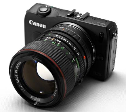

There are lots of very fine digital cameras that can easily use FD lenses with inexpensive adapters that do not degrade image quality.
What is wrong with this combo?

Mike nothing is "wrong" if that is your cup of tea.  But neither he nor I have a Sony camera! (I wouldn't have one but that is another story.)
 And you are only fooling yourself if you think adapters don't degrade the lens.  It simply is not possibile to 'add' to a lens and maintain the exact same specs as it had without the adapter.  Even the best, Ed Mika, changes the lens some tiny amount.
It is this tiny amount of quality you are so diligently trying to keep and brag about.  The Siggy is there and has none of the issues.  Plus it is nearly the same price.
You can not believe how hard it was for me to finally give up on this adapter route for the FD lenses I have and love.
I have about two dozen of them still.  I still have my F1n and A1.  I still use them but as they were originally intended.

 "And you are only fooling yourself if you think adapters don't degrade the lens.  It simply is not possibile to 'add' to a lens and maintain the exact same specs as it had without the adapter".
Nothing is being added. There is no addition lens. These adapters are glass-less and do not effect image quality in any way.
If I had a bunch of quality FD lenses, I would pick up an EOS M camera and an inexpensive adapter so I could use them all.

"These adapters are glass-less and do not effect image quality in any way. "
Yes they do but I give up.  You win!
Anybody that would recommend getting a EOS M camera so they could use old FD lenses is...........Smiley Frustrated..............well at least well beyond me.  Have at it and more power to you. Smiley Happy
Sorry, I don't mean to be difficult or disrespectful. I just don't understand how a glass-less adapter or mount change affects the image quality of the lens. Could you please explain?  I must be missing something.
