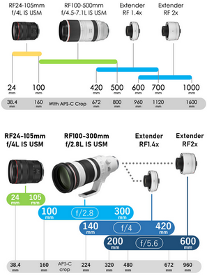

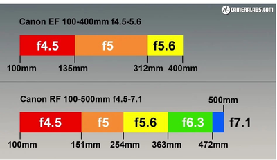

Currently only have kit lens18-150mm f3.5-6.3,So definitely going to rent lens ,But unsure witch to rent.              Question thinking 100-500 ,But 100-300mm f2.8 with extenders great range with lower Fstop see below
But on 100-500  were is F stop with crop 151 lens  camera 241 and 254 -406 363-580 is that a correct assumption. But cost to rent with ins includes damage & theft 100-500 $240.where as 100-300 Dramatically     more $886. But far lower F-stop ?Do I need lower f-stop?                                                                                    Thanks once again for your help!

To give you a quick comment on lens performance: the RF100-500 f/4.5-7.1 compares better in both range and speed to the RF 100-400 f/5.6-8 by about a stop, so you are better off with the more expensive optic and its longer focal length.  If you were to add a 1.4x extender (which would cost you to rent or buy) it would change the base f/stops of the 100-400 to f/8 - f/11, so the diagram you present would be invalid for that scenario and the lens would be slower by one stop across that range, and would only result in an effective increase of FL to140-560mm - so you lose at the wider end (which could be very useful) and gain only 60mm at the long end.  I would not add an extender to the 100-500 as it means the lens with the extender attached will only shoot from 300mm because there is a mechanical stop, so you might be looking at an on/off cycle that is again only going to increase the risk of dust infiltration.
Then we come to the question of Equivalence.  The actual Field of View that your lens + sensor will capture. Since you are using an APS-C lens, the actual FoV is equivalent to using a lens with a FL 1.6x the value of the optic,  and also increased the effective f/stop by about 1 value. So the range of FoV would be as follows:
RF 100-400       FoV Equivalent = 160 -640mm f/8-f/11  With extender 1.4x = 224 - 896mm f/11-f/16
RF 100-500       FoV Equivalent = 160 - 800mm, f/5.6-f/8

No other lens I was talking about new rf100-300 F2.8 chart of f-stops below email  but costly to rent new 9000. Was curious if needed low f-stops lens or what to do in low light
David
The new lens RF100-300 is short on focal range for a start, which is much more important for wildlife, especially with macro mammals.  As I said there should be plenty of light normally.  If you are intending to shooting in very low light, I would recommend taking a monopod, but given the higher ISO performance, you are likely not to need it unless you are shooting in very, very dark conditions.
