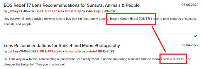

06-06-2023 09:14 AM - edited 06-06-2023 09:21 AM
Seems to be a discrepancy here.
06-06-2023 09:50 AM
Honest mistake! Sorry 🙂
06-06-2023 09:54 AM - edited 06-06-2023 10:04 AM
@_abbey wrote:Honest mistake! Sorry 🙂
Noted. Its just that you've made reference to 3 body's here or elsewhere.
