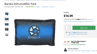

For portable solution to use within your pelican cases, you can use something like this (you can reuse by microwave)

Micha, I know it won't help with you current challenge but you may want to consider picking up some Silica to add to your cases. I use these in my cases and so far they appear to do what the are indented. I use the large canisters in my dry cabinet for extra protection.

Marc,
Those work good too. 👍
Unfortunately  some environments are particularly challenging.

As to the use of silica gels bags they are totally useless unless they are used in an airtight case or cabinet. Silica gel bags absorb moisture and become useless unless they are dried periodically. If you are using them in a camera bag where you routinely open it, forget silica gels bags.
