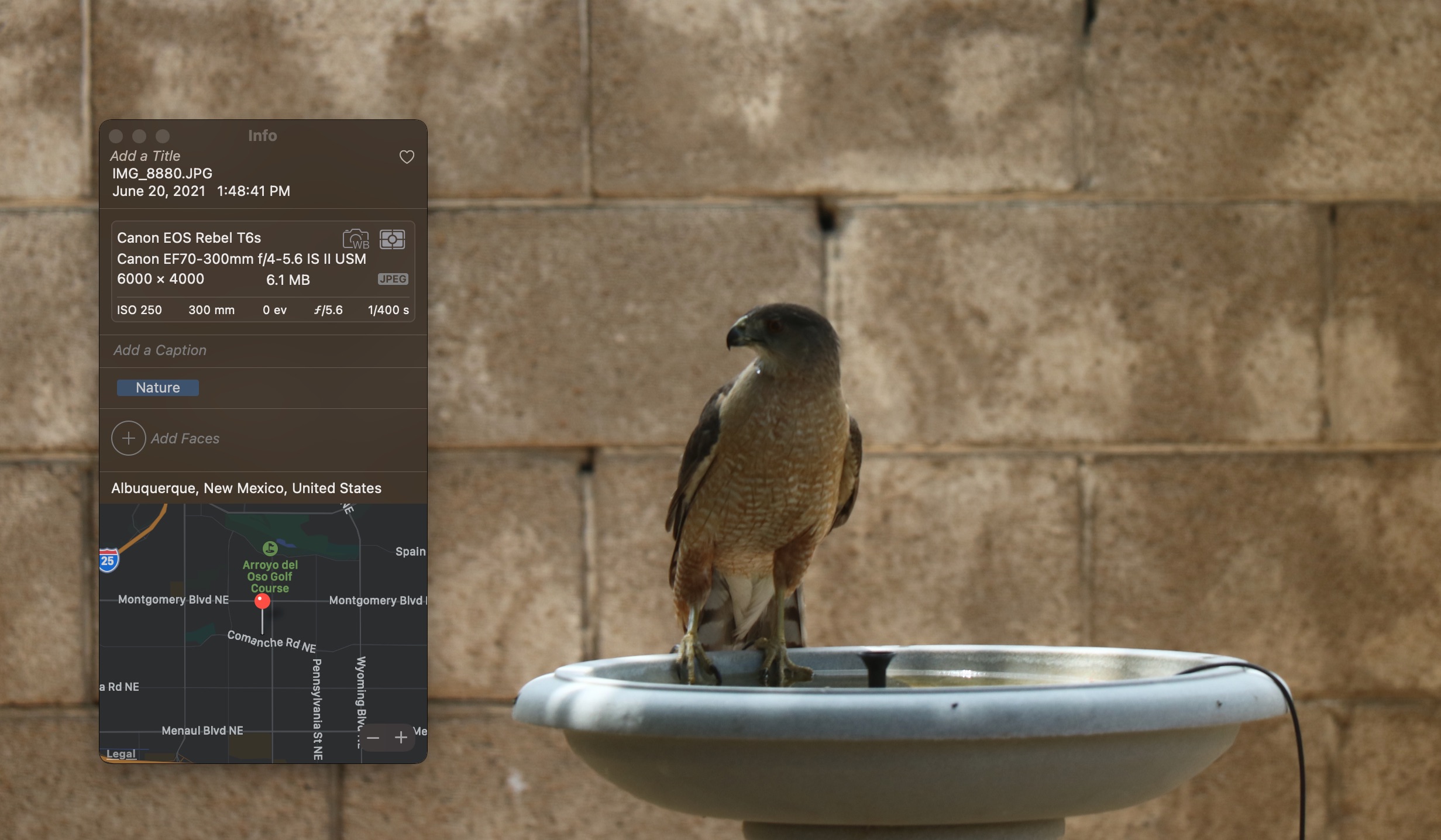

07-11-2021 02:54 PM
I do, it reports 112-480 on its LCD on my Rebel T6S. And the EXIF shows 300 mm
