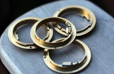

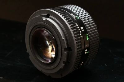

I've seen the Ed Mika kit, or another one like it. They are not adapters which keep the FD lens intact. They are CONVERSIONS which replace the FD mount on the lens with an EF mount. For what they cost and require, not something I was motivated to do.
Ed Mika made both adapters AND conversion kits,  at various times.
Very early on Ed Mika started off manufacturing some very thin 0.75mm thick FD-EF mount adapters. These worked well with Canon FD super telephoto lenses that had extra focus travel built in. They did not well with regular lenses like the FD 50mm as they could not achieve infinity focus.
Later on ED Mika produced kits that replaced the entire FD mount with an EF mount. The first ones were brass, and then he later switched to black polymer.

Here are some photos of the original Canon. There is one for sale right now on eBay for $324.
4D99A535-301E-48BC-8B98-117D6AA6106F.jpeg10AAE425-3350-4225-9E66-99FC6DA3EABD.jpeg1907C56F-F2DD-4B66-95B7-B328064DD3DB.jpegAE6C1F4E-75A8-4C5B-A50F-469E6C17BC11.jpeg
