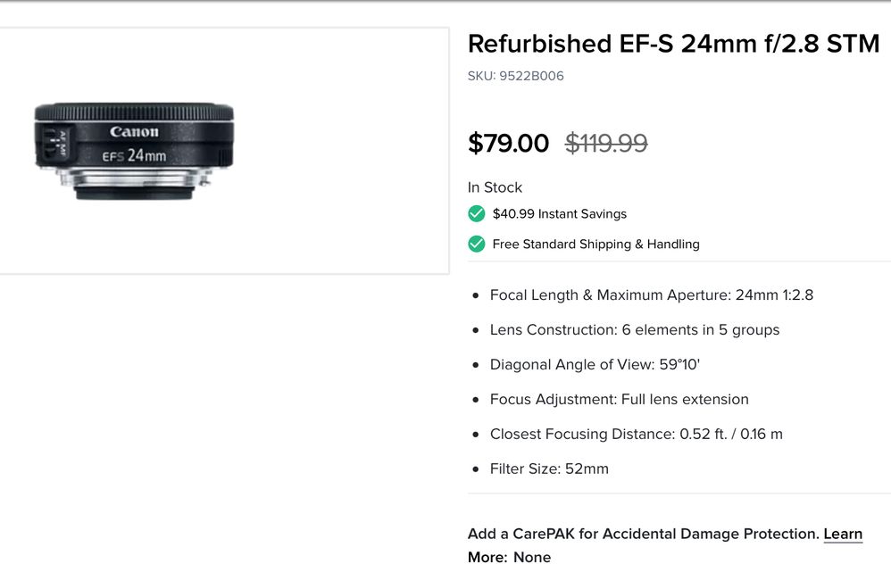

It would seem that you want to take some landscape shots of golf courses. I would say to match what you've got, which is no slouch of a camera, just a little old, the kit lens would do a good job. You could go for the EFS 10-18 IS STM which is affordable and quite good. Or even the 24mm "pancake" lens could give good results. If you'd like to get closer, the EFS 55-250 IS STM is more than capable, and the EF 70-300. Lots of choices that would give good results. At those hours of the day a tripod is a must. Oh, and to get those deep greens and early morning blues I suggest a polarizing filter. Just my thoughts, golf courses are quite scenic at those hours.

The standard camera kit lens, EF-S 18-55mm, that came with that model was not very sharp.  Check the Refurbished section of the Canon USA Online Store.  See if this is still in stock.
