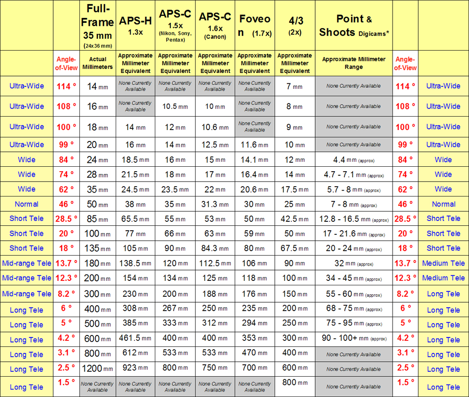

Crop factor is a big joke.  It is a meaningless term invented to slap on certain sensors because they had to come up with something.It is nothing short of confusing to most people.  Even long time photographers think the crop sensor camera actually crops their image. People on all the photography forums will say so. It crops nothing!  All camera no matter what size sensor they have are FF in the sense that you get what you see in the viewfinder, nominally.
If you notice they don't call P&S cameras "really cropped sensor".  And they don't call medium format cameras "expando sensors".
Again if you have a 50mm lens and could put it on a P&S it would still be a 50mm lens.  Even putting it on the medium format or large format body, it is still a 50mm lens.
A better way to think about it is "angle-of-view".  There are charts that quickly tell you exactly what it is.  On your 'crop sensor' body you need a 18mm to 16mm for a WA angle of view.  A 14mm to 10mm is considered an ultra wide angle.

Thanks for the walk through memory lane. I think I got it now. 35 mm (24mm x 34mm) was dubbed a standard and hence dubbed "full frame". Anything other than a "full frame" size is just a different frame size and hence has a different angle of view. A way to express the angle of view is to compare it to to the standardized "full frame" via a ratio or multiple, such as 1.5, 1.6, 1.35, etc.
