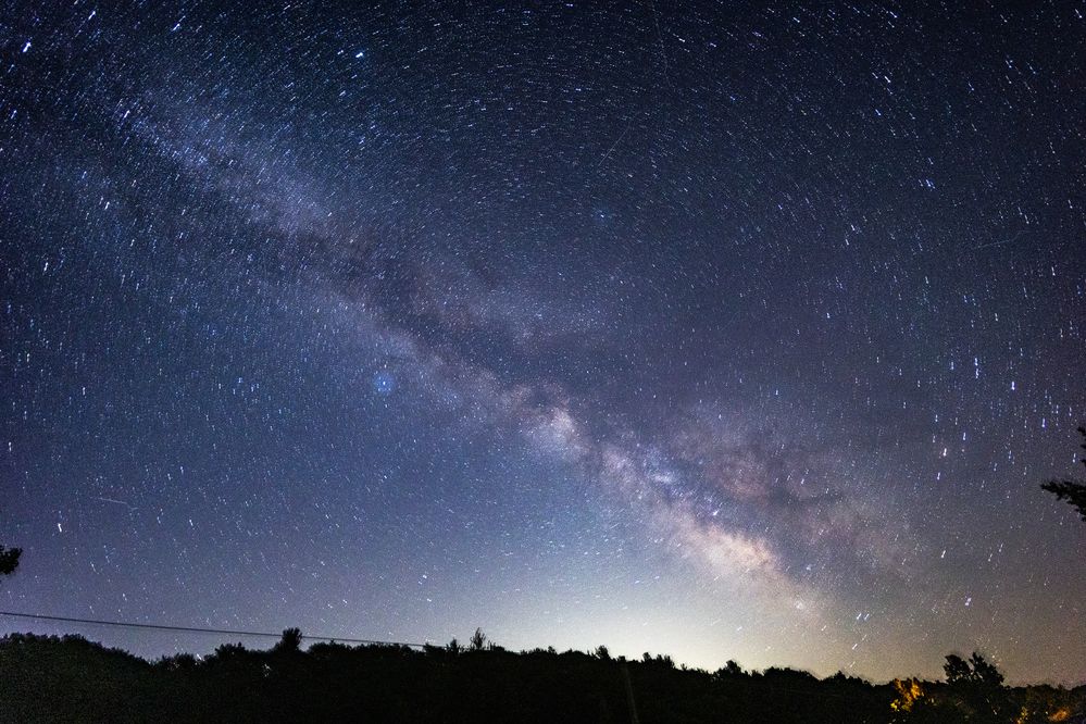

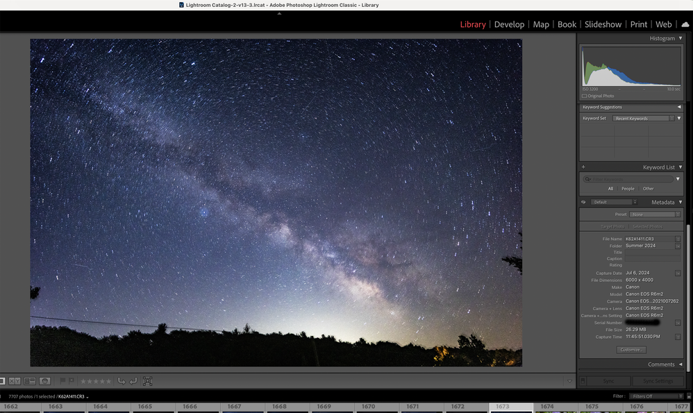

I can't answer for lens IS being on or off if the camera is on a tripod, but I can answer for IBIS being on when the camera is on a tripod.  When I first bought the R6 Mk ll that was the first camera I've owned with IBIS.  On long exposures I was getting a jittery rotation effect that even had the Canon technician stumped for a bit.  While I can post dozens of similar shots as samples, I think this one, plus the Lightroom screenshot with the data off to the right should suffice.  Also, the thing the Technician kept saying to me is "Well, on a 10 second exposure, the Earth rotates, so that's the problem".  I came back with that even though the earth rotates, stars will go in a circular pattern around the North Star in the northern hemisphere.  This photo was taken facing south-east.  Rotation would have been a sideways curve throughout the whole frame, not dead center.  This happened every direction I turned the camera - dead center rotation on anything longer than one or two seconds.  We finally figured out that something was turning the IBIS back on every time I switched the camera off to change lenses.  Luckily a camera reset and updated firmware fixed it.

I saw that with one version of EOS R5 firmware, but it was quickly fixed with the next version of firmware, or maybe I fixed it by turning off tracking in autofocus. I cannot remember which.
