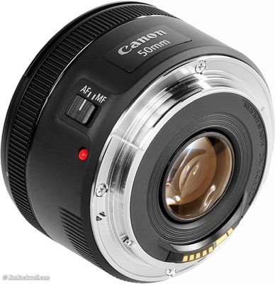

I was doing some deep cleaning with my lens and when I put the back panel back on and put it on my camera the aperture setting wouldn't change and it would even let me focus idk what I've done wrong.

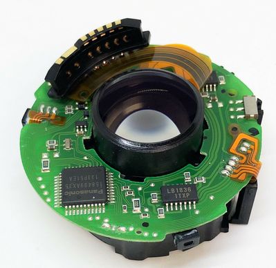

When you say "deep cleaning" do you mean you dismantled the lens to clean it, if so then you have probably dislodged or damaged an internal cable.

What do you mean by "back panel"?  Do you mean the plastic insert in the rear lens mount?

I was using the lens pens retractable brush and a water down glass cleaner with a soft cloth and yes the plastic inserts on the rear lens mount
There really is no reason to remove the plastic insert when cleaning the lens. It exposes the delicate electronic circuit board and connectors. My guess is that you may have damaged some of those electronics.

Unless you can see if you dislodged anything or let it alone for a long enough to see if it dries out, the cost of shipping alone will probably be more than a used 50mm f1.8 is worth to repair.
