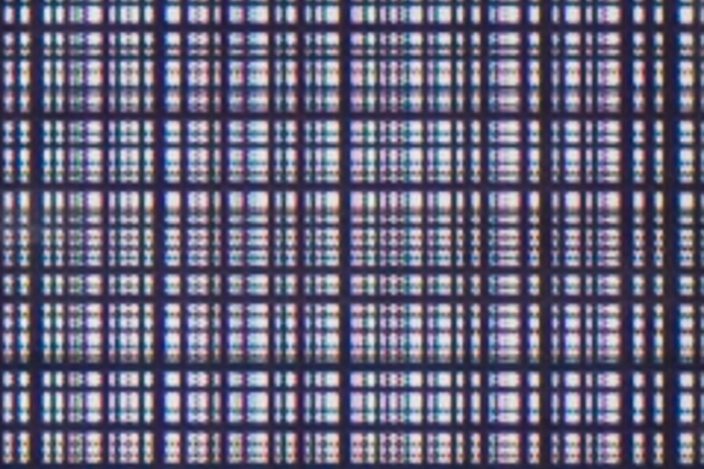

I've just re-registered all of my lenses on 7D body and included my just-purchased EF 16-35mm f/4.  It is the only lens to give me trouble, no matter at what focal length or distance from test pattern I AFMA, when I increase distance and zoom in I am seeing significant color fringing and soft focus.
First AFMA was at 5.7ft, 35mm f/4.  At this distance test photos show extremely sharp focus.  However, when I increase the distance to 20ft and fire off a test shot, this is what I see (image has been cropped and resized to simulate LR 3-1 view)
I have also gone through the exercise of AFMA at 20 ft, which is more realistic than the default focal length mm x 50 with same results.
I am not seeing this type of result with any of my other lenses, a mixture of EF and EF-S, both primes and zooms.
Do I have a faulty lens?  I still have a few days before my return window is up, advice appreciated.

Same lens?  Same camera? Same settings except distance in a few feet?  You shoot at 5.7' at f4 at 35mm and all is well but if you move that same set-up to 20' all is not good?
I think I would do the test again and really check my set-up.  Smiley Frustrated

Yes, Same lens, same camera.  No on same settings.
The first execution of AFMA was at a distance of 22' from target.  Since I will be using this as a landscape lens it made little sense to do it at 50 x focal length (Canon recommendation).  DotTune method was used.  When completed I did an AF test photo.  At 22' the results are shown above, zoomed and cropped to simulate Lightroom 3-1 view.
These results looked terrible, so I thought OK I will use Canon's recommendation.  AFMA re-executed at 5.7ft (50x35mm), f/4. AF test photo looked spot on when taken at 5.7 ft.  When I dropped back to 22ft, test shot when zoomed in is the same as above.

This lens is reported as the sharpest WA zoom Canon has ever made.  I don't have one so I don't know personally.  But how do your photos look?  Forgetting the focus tests, real world photos?
If you are truley worried about it, I would return it and get another copy.  If you don't you will always suspect it and won't enjoy it even though it may be fine.  If you do decide to return it and get another one, don't test it.  Just use it and enjoy it.

I will be taking delivery of a new 6D today (can I get a yippee?), hopefully the results will be different.  The purchase of this lens was a first step in migrating all but wildlife photography (I will keep the 7D) over to FF. There have been limited photos taken at this point, but I can say that I am extremely impressed, I am not seeing the color shift evident with the test pattern.
