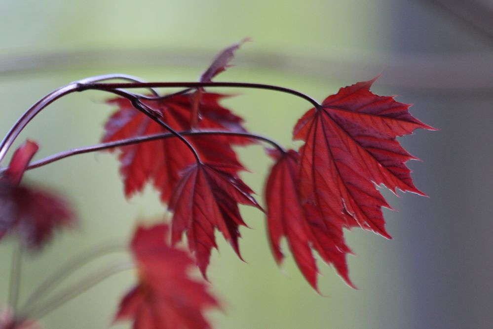

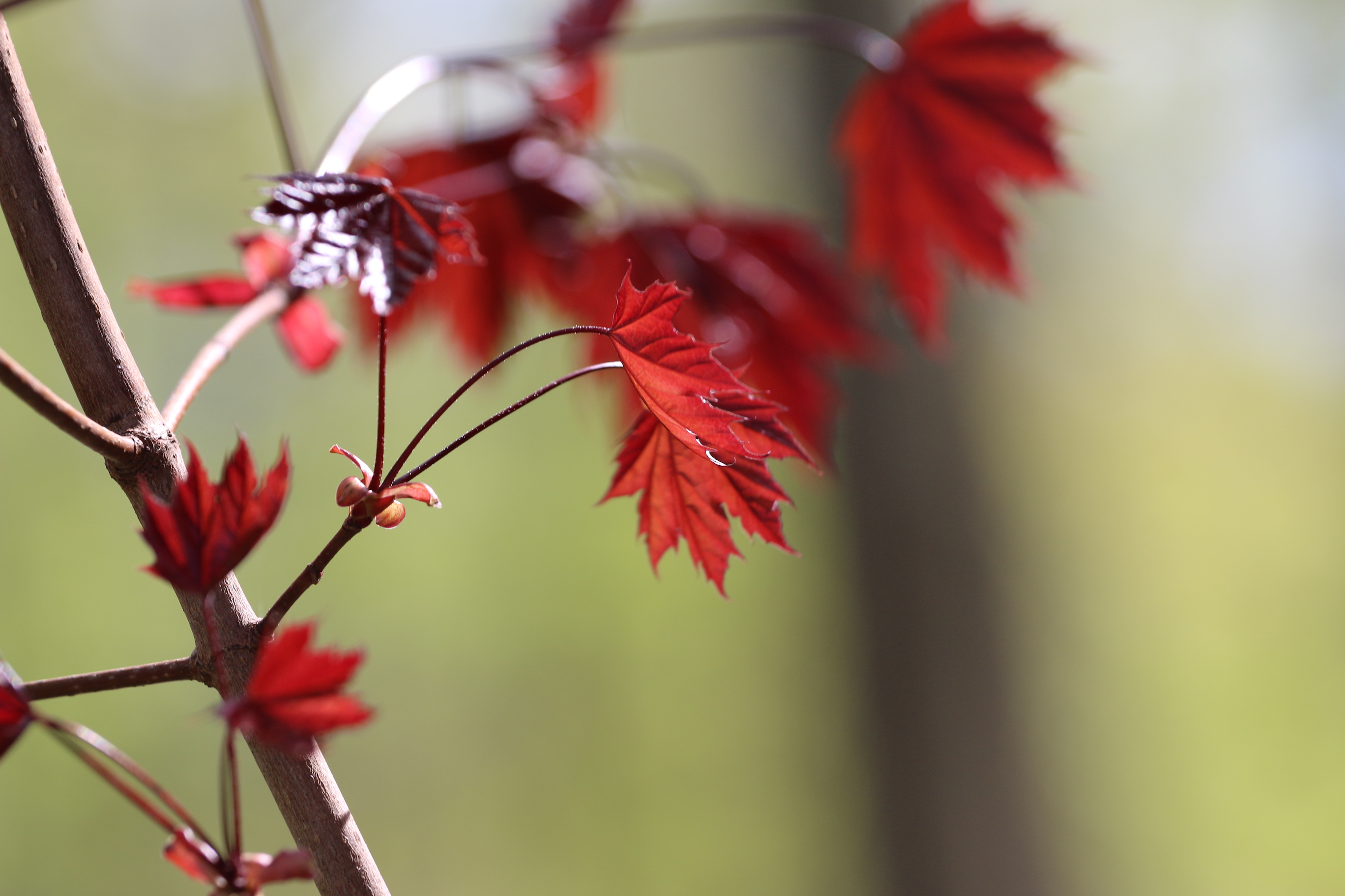

Hi. New here. I've had a 70D for a couple of years now, and I will freely admit this is too much camera for me. It requires too much thinking and remembering on my end. That said, I can typically do fine with it. However, I've run into an issue that I think is just lens-based. I got a 70-300 IS a while back and it just refuses to take clear images. I did some tests compared to my EF70-200 and 17-40 USM. Of course, the 300 has the greatest zoom, which is what I prefer to use when taking pics of wildlife. I'm not sure what to do, as the lens is way out of warranty, despite not having a ton of use since I got it. Is there a way for ME to fix this, or does this call for a repair? IMG_5731.JPG
Taken with 70-300 IS
Taken with 70-200 USM

I think the images look fine.  Assuming that the photos are not cropped, then your DoF, Depth-of-Field, should be quite narrow.  Visit the web site DofMaster dot com.  Punch in your camera body, and the focal lengths of the lenses.  You will see what I mean.
ebiggs1
"I would agree that you have a defective lens."
I don't, Smiley Frustrated at least not from the two sample photos.  The first one is OOF, simple.  You missed focus or you moved or your SS was too slow. Whatever that ones on you.  The second one is in focus on the very first bud or leaf whatever it is. That, as stated above, looks fine.

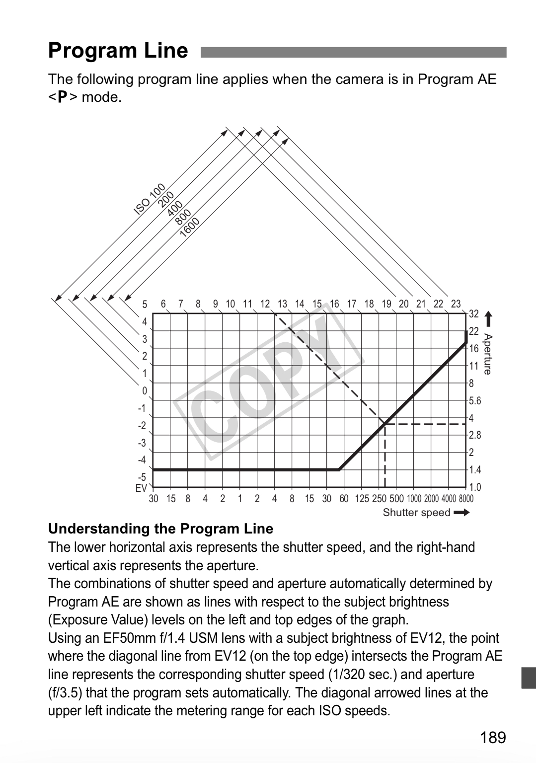

I do not think that P takes focal length into account.  The exposure settings will be determined by the brightness of the scene, the EV value measured by the metering system, and the ISO setting.  All exposures will fall somewhere along the bold line.
I seem to recall that Av mode might compensate for focal length.  I am almost certain that Canon DSLRs take focal length into account in Av mode, by trying to maintain a minimum shutter speed that is related to the focal length in use.  This is why you may want to use ISO in Auto mode, which will give the camera a wider range of shutter speed options.
