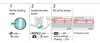

As to the red lines that appear around objects while in manual focus mode, that is likely the  MF Focus Peaking feature that will outline what is precisely in focus in the colour of your choice.  I refer to the User Manual:
User Manual (c-wss.com)
