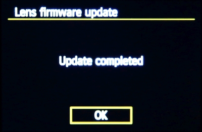

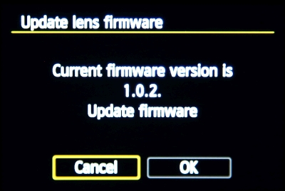

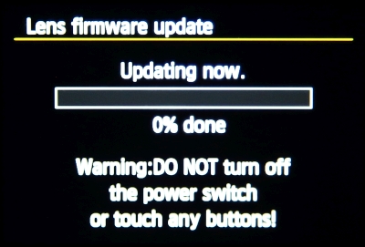

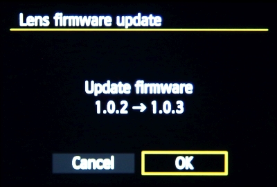

A few years ago Canon added to option to update the lens firmware to all new Canon lenses being produced. The update is done exactly the same way the camera firmware update is done.
The the EF 40mm STM and EF-S 55-250 STM are two lenses I know of that have had firmware updates issued.
Edit: The EF24-105 IS II also has a firmware update.
Here is what the 55-250 STM update process looks like:
Firmware Version 1.0.3 incorporates the following enhancement.
Improves the autofocus speed when the EF-S 55-250mm f/4-5.6 IS STM is attached to the EOS M3.
