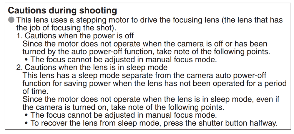

Hello Radiux welcome to the forum and happy holidays. I also own the EF 50mm F/1.8 STM lens. All STM and Nano USM lenses are Focus by Wire/ utilize and Electronic Focus Ring. The camera metering system MUST be active for the electronic focus ring to work. You're lens is working as designed and there isn't a problem with it. Does Manual Focus Override work correctly too. Click Here for the manual for your lens. Click Here for the manual for your camera.

It sounds like it is working "as designed". When the exposure settings disappear in your viewfinder, the camera is going into a semi-sleep mode and needs to be woken up before you can do anything. So half-pressing the shutter button will wake it up to either autofocus, or now allow you to manually focus. I think your lens is working fine.

Here is what I have noticed with all my STM lenses:
In One-Shot Auto Focus, the focus can be fine tuned (Full Time Manual focus) anytime the shutter is half pressed. As soon as you take your finger off the shutter the STM AF goes dead. (really more like part-time manual focus) 😉
In AI Servo Auto Focus the focus ring is always dead and you can't do manual focus over-ride or fine tune the focus.
In Manual focus the focus ring will be active while your finger is on the shutter button, OR while the metering is active. It will also continue to operate with your finger off the shutter button, but the lens will "go to sleep" after approximately 5 seconds after the metering stops. You won't be able to focus again until you half-press the shutter and start the metering.
But......If you continually adjust the focus ring, the STM Manual Focus will continue to operate for as long as you keep moving it. (even long after the metering has stopped). If you stop adjusting the focus ring, the lens will go to sleep again after 5 seconds. A quick tap on the shutter button starts the metering again and the STM focus will operate again.
