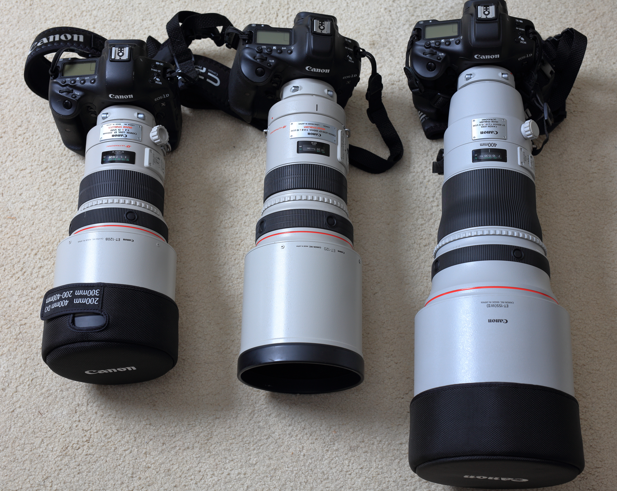

I agree Ernie about primes and I assume rs-eos is referring to those cases where the primes do have a wider maximum aperture than readily available zoom lens, particularly as you move into the telephoto range. I use prime telephoto lens often for sports because an extra stop really helps sometimes on dark fields even with the ISO performance of current bodies. More importantly for sports, the better primes acquire focus a little faster than a similar focal length zoom and the extra stop allows the camera body/lens combo to focus even faster (relative to a zoom) when light conditions grow worse. But this performance comes at a big cost in terms of dollars and versatility and modern better zoom glass is so good that for most shooting situations it is the best choice.
Shooting a lot of high school sports with the typical poorly lit venues makes me an outlier in terms of which characteristics of lens performance are most important.
Yesterday I calibrated 5 different lens (400 F2.8, 300 F2.8, 200 F2, 70-200 F2.8, and 24-70 F2.8) to my three different 1DX series bodies so that I can safely switch a lens between them on the fly if needed. I am planning to use some soccer team practice sessions to try some different shooting setups and today I am going to try shooting scrimmage with a three camera setup using 400 and 200 primes along with a 70-200 zoom to see how I like coverage from a fairly static position near the goal area. But this setup means in addition to my game setup 1DX series bodies I will need to throw the 5DS R with a 24-70 2.8 on it into the bag to get bench and group shots when needed so by season start I will probably just go with a 400 F2.8, 70-200 F2.8, and 24-70 F2.8 three camera setup that will do it all. Most of the JV games early in the season occur after sundown so the F2 200 provides some advantage there which is why I want to try it during practice sessions that run after sundown.
My plans for getting a lot of photography testing in during pre-season practice were somewhat diminished yesterday when I got drafted as an assistant coach but that will probably be the most enjoyable unpaid job I have ever done 🙂 It is a fun time to work with the team because the last of the kids I coached when they were little are now starting their freshman year so I get a few more years to work with them.
As a side benefit, the heavy primes keep me in shape (at least that is what I tell myself) 🙂 Photo is from getting ready to start the calibration process yesterday. It took about an hour total and none of the lens required more than a minor offset with most being dead on without adjustment.
