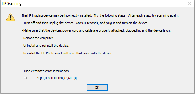

Hi all,
I just installed Windows 10 and I am having issues connecting my Canon imageFORMULA P-150 scanner. I am using the program PaperPort. When I load PaperPort and select the P-150, I get the following error message, which is very strange to me, since it is coming from HP...
I've tried to uninstall and reinstall - that hasn't worked. I deleted and updated drivers - that also hasn't worked.
Any ideas?
Thanks!
