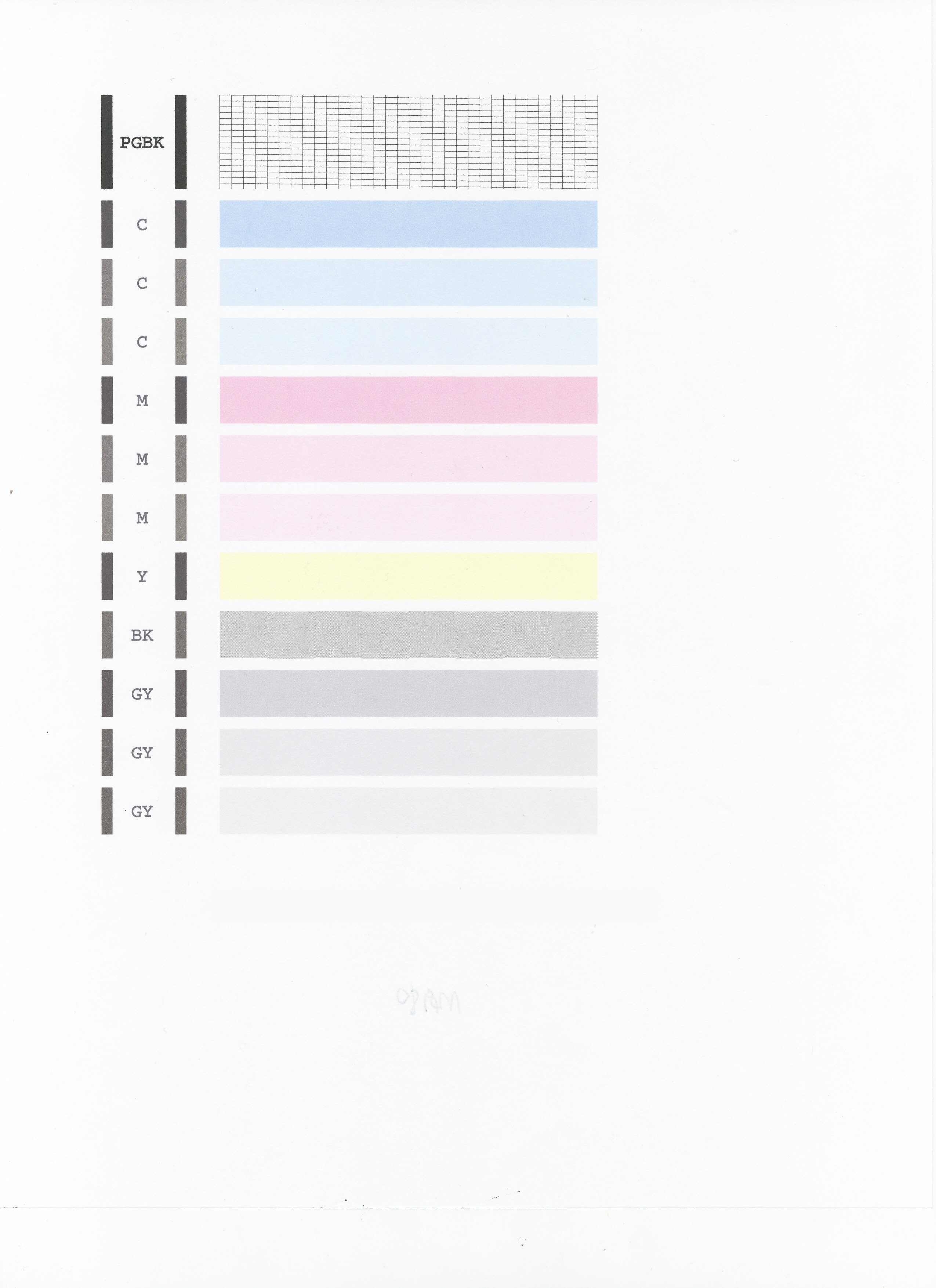

First, let's perform a test of your PIXMA MG7520. To do this, please follow these steps:
1. Please swipe the HOME screen and then tap the wrench and screwdriver icon on your PIXMA MG7520
2. Tap Maintenance
3. Tap Print nozzle check pattern
4. Tap Yes
Please compare your printout with the example provided below. Does your test page print correctly?
If not, please return the maintenance menu to perform a cleaning.

The PGBK part of my nozzle check pattern is not printing at all. I have replaced all ink cartridges, cleaned, deep cleaned twice with a 24-hour wait time in between deep cleans as recommended. What else should I try?
