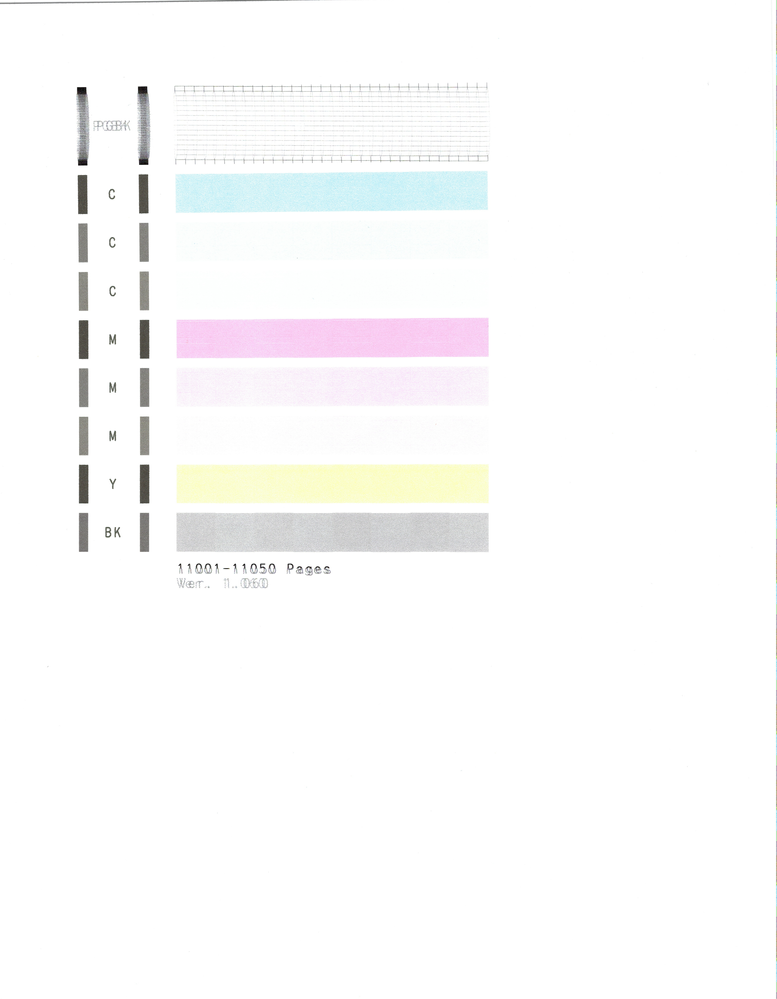

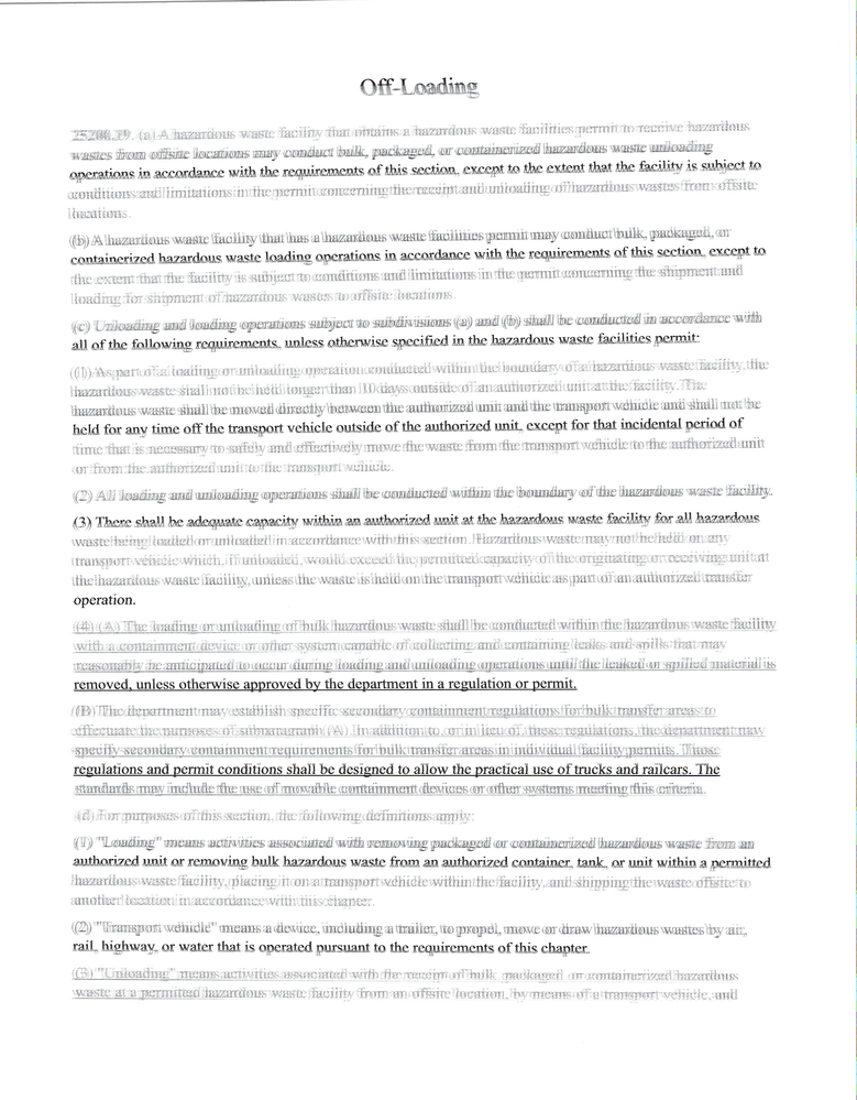

First I could not get any black to print. I bought a new print head. Now the PGBK is misaligned. Nothing seems to work to fix it. Clean print heads, alignment. I have cleaned the timing strip.attached are the prints of alignment check; and the manual alignment tool; and a full document print. Nothing I do seems to make a difference on this issue.alignment check.pngalignment check.pngmanual adjust.pngmanual adjust.pngpageprint.pngpageprint.png

Hi wadeR,
Based on the images that you provided, it would appear that the encoder needs to be cleaned.   I know that you have already performed this, but please perform it again.  To clean the encoder, please follow the steps on this page:
https://support.usa.canon.com/kb/index?page=content&id=ART171023
Once cleaned, please attempt to print again.  If the issue persists, your PIXMA iX6820 would require service.
