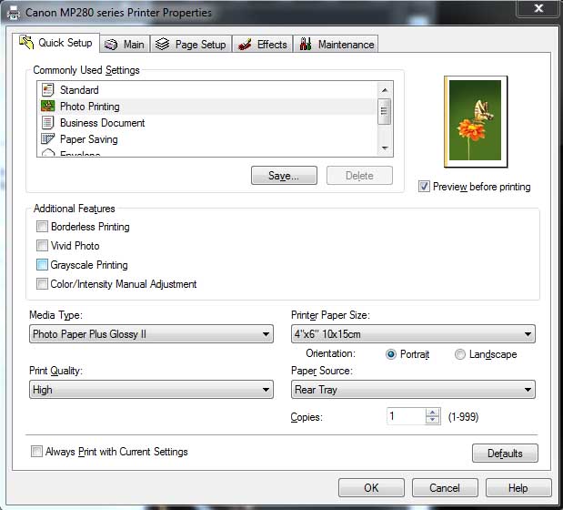

I've had this printer for over a year, but have only now tried printing photos. I 1st tested printing on plain paper to check alignment and basic quality, and the printout looked fine. So I unwrapped the sample package of 4x6 Canon Photo Plus Glossy II paper, and put one in the printer. Printing through Photoshop CS6, I went to the printer settings and configured:
* Common Settings: Photo Printing
* Media Type: Photo Plus Glossy II
* Printer Paper Size: 4"x6"
* Print Quality: High (also tried Standard)
The resulting print resulted in everything going red.

I'd really appreciate hearing from anyone who may have an explanation of what's going on here, or what I may be doing wrong? .Thanks.
