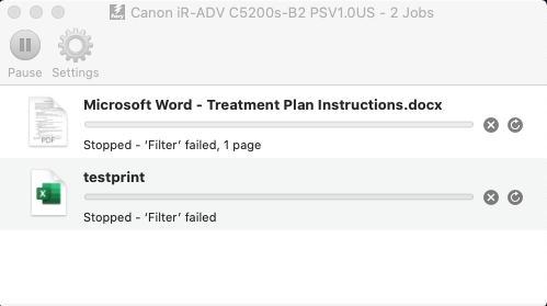

I updated my Canon Pixma MG6320 in anticipation of ios Catalina and now I get this error message every time I try to print:
Stopped - 'filter' failed.
I've tried turningk my printer off, then back on and nothing changes.
Any thoughts?

I am having the same problem after Catalina. Except it started with the scanner. I think the printer may have been working. I tried to scan, and got the message "you cant use this while it is in use by another application" or something like that. So I followed the advice on one of these forums to reset the printer, and nothing changed EXCEPT, now I noticed I cant print either.

I updated to Catalina and my MG6320 still works but I had a problem. First, I have it ethernet connected, not over WiFi. I am running the CUPS driver v16.20.0.0 from the canon website. The problem I ran into was that the printer dialog box no longer contained the printer speciifc options, like grayscale, which I use quite a bit. I tried all the typical stuff, like reseting the printer system, removing & adding the printer, etc. and nothing fixed it. But I used lpadmin to set the options and that worked. So my MG6320 works on Catalina, I am running their latest driver, and I use lpadmin to configure it's default options.

I'm having the same exact issue.
