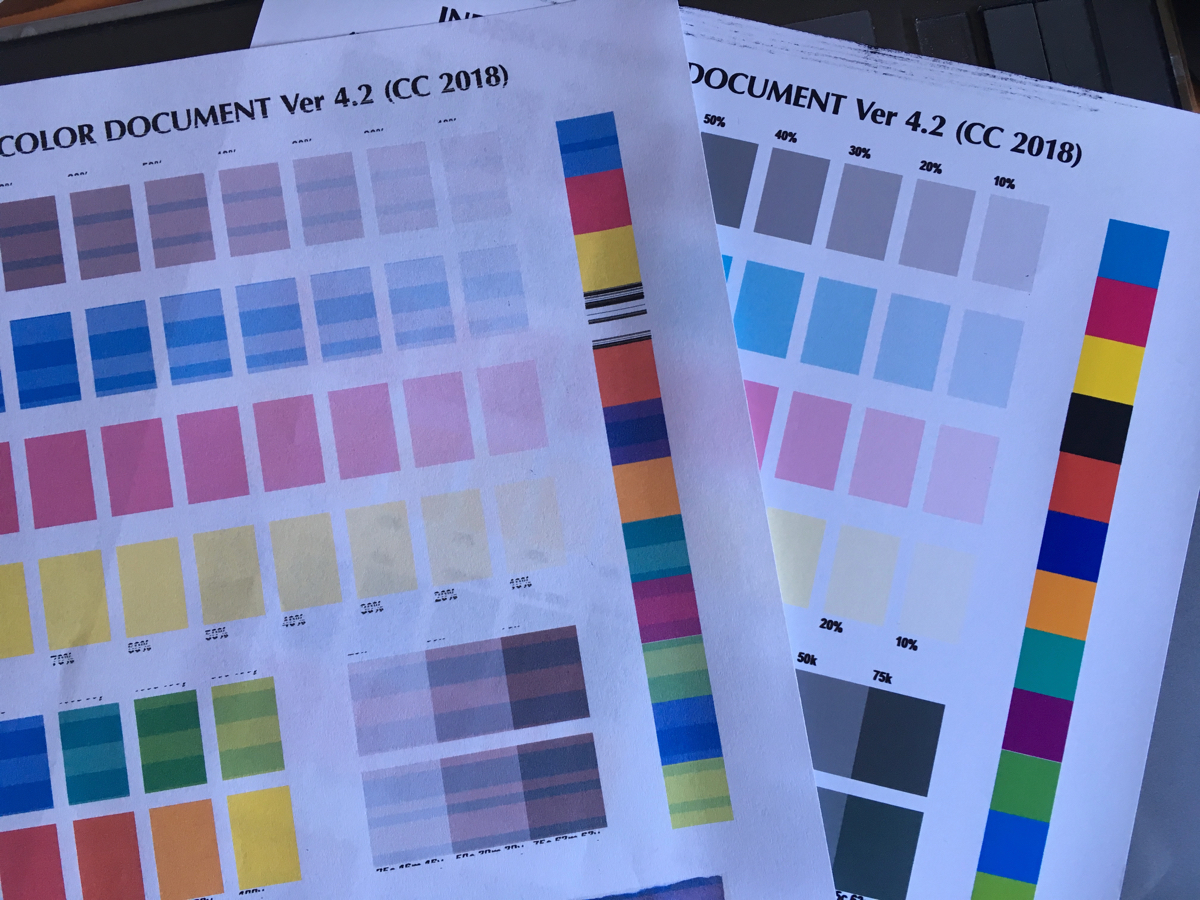

I have suddenly developed striping on my MG6220, particulalry from the CYAN ink tank. These stripes appears in plain paper printing at standard setting. However, does not apprear on high-resolution paper setting, which prints normally on Presentation Paper and Glossy Brochure Paper..
I have already performed several standard and two deep cleanings in maintainence to no avail. The problem shows up on test prints in the Cyan band. Magenta, Yellow, Gray, and Pigment Black seem unaffected. Standard Black shows some fine lining.
As seen in a different thread, have tried differnt paper, settings.
Any help would be appreciated.
Test Print: (ignore show through. previous test on back of sheet )
Left: Hi resoluton paper seting on Brochure Paper. / Right: Plain Paper on injet multipurpose paper.
Test Print (ignore show thru, previous test on back of sheet)

Oh, here's all that worked out. I DID try... Standard Qyality on the Left, High Quality n the right. (I was able to clear out the pigment black after multiple cleanings - no luck with the cyan. ) The entire process cost me so far about $120 just in ink. Egad.

I have this exact same issue. (The sample shown looks like it came from my printer). I have done the cleaning. I have removed the print head and cleaned it completely. Even soaked the head (just the printhead not the whole thing) overnight. With the exception of cyan it is perfect.This issue came on suddenly the same as (SamuraiArtGuy)'s. Is it possible this is a driver issue? I am suspicious as seem to remember a software update about a year or so ago. I have a imac. As I recall the old software had a separate scanner app and now this software has the scanner intigrated so I need to go to settings and select scanner from there. I realize I am providing a lot of information but would like to get to the bottom this issue.

Although I am not an expert on injets it would seem to me that chaging the output from normal to photo would not fix te issue but it does. When set on photo the output is perfect. When I said my nozzle check pattern was exactly the same as the sample shown I was truthful. Exactly 1/2 of the cyan test line is lighter than the second half. Does the printhead make two passes to produce the pattern? I believe it occured when a newer driver was downloaded but as I said not positive. I removed the print head flushed it and let the print part soak over night and the results were the same. If the issue was hardware would it go away just by changing to photo? It seems more like the voltage applied to the cyan check was not strong enough. I am still trying to get the original drver. Any help with that would help pin down the issue.
