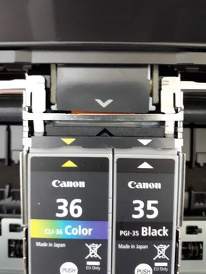

Thank you for replying. Even after following your instructions the problem remains. I'm attaching an example of what's happening. What you see at the top also happens at the bottom if printing a full page. Also, this is printed as a draft. If printed with regular setting it's much worse.
While reseating the print head, I noticed something, but I'm not sure if this could be a problem. The part with the top arrow is not completely parallel with the rest.
Another thing I might add, is that the automatic head alignment wasn't working. I kept getting an error. Had to do a manual alignment.The current problem was present before and after the alignment.
Any help is greatly appreciated.
