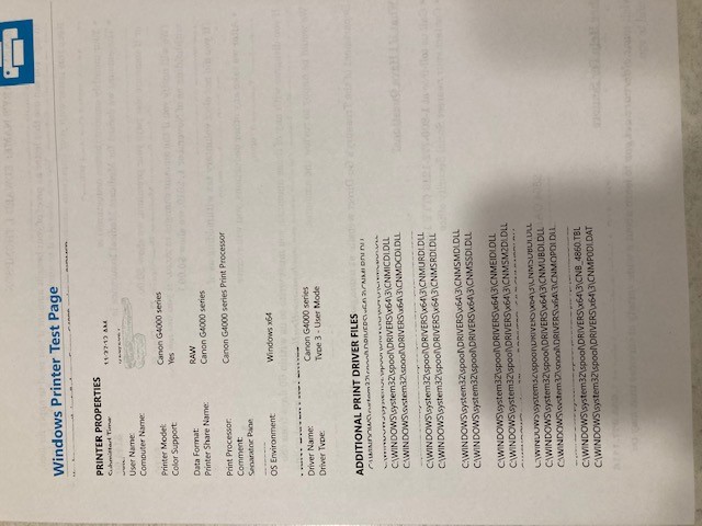

We are having an issue with our Pixma G4200 as it is skipping lines of print throughout the page. We have run the nozzle cleaning programs several times without success. I have attached a couple of examples for reference.
Thanks for any suggestions.

If this is not a problem with ink delivery / clogged , mis-aligned or defective printhead, I would suggest you have a look at he printers timing strip.
https://support.usa.canon.com/kb/index?page=content&id=ART170551

Rick-thanks for the the link. I think this is likely the issue as I performed all nozzle maintenance tasks previously.
