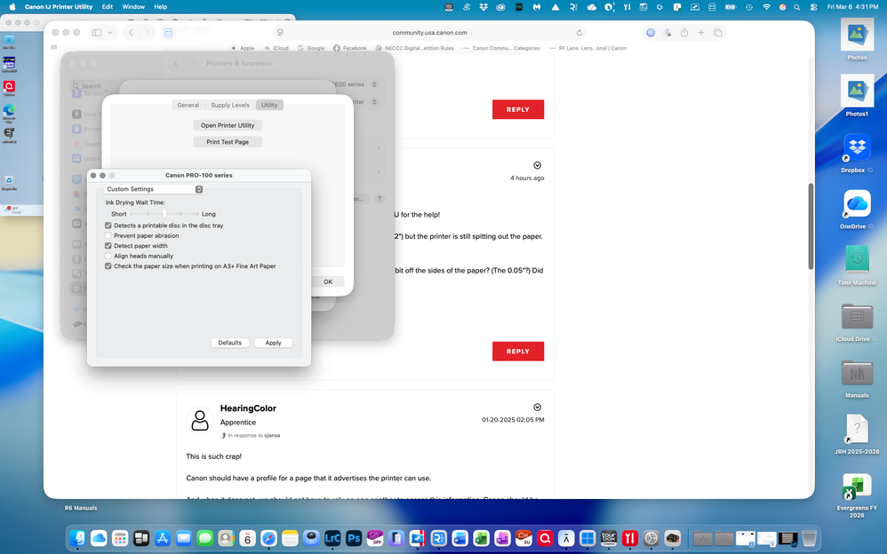

Try unchecking detect paper width setting.
