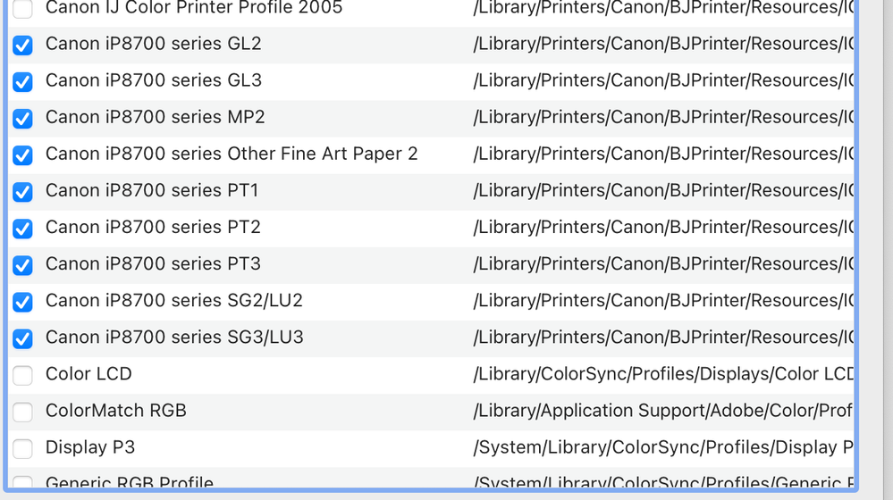

I just got a canon pixma ip8720 and im trying to use the icc profiles for all the canon papers. When I loaded them into Lightroom from the printer the names don't match to the names of the papers (attached image). Are these the right icc profiles for canon paper or did I load the wrong ones?

They are the correct profiles.

Hello,
My IP8720 only show the below profiles (for Canon Paper) and I install every single dirver/manuel etc from the website, where can I get the full list of ICC profiles?
(I am looking to print now on the Canon LU-101 LTR Luster Photo Paper Letter, not on this list)

The ones labeled SG2/LU2 and SG3/LU3 are for the SemiGloss and Luster papers. Quality level 2 and 3.

Thank you John, One last question on this matter, where do I find the 'quality' type on the paper package?, for example, for this one, assuming it is a SG3/LU3 ?
Canon LU-101 Photo Paper Pro Luster

The quality type is related to what you select when you are printing; paper is the same.
