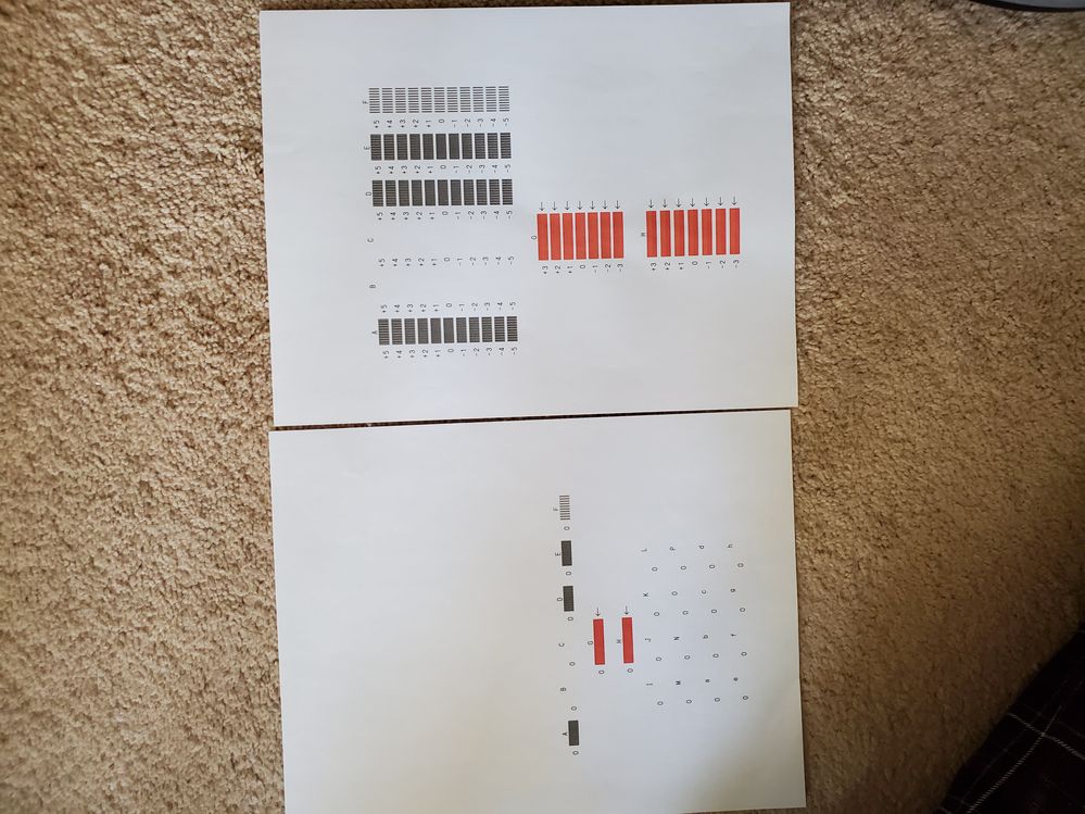

I have run through all the diagnostics as well as cleaned the printer heads and stil when I attempt to print color I get pinks. I'm attaching two pictures. One is of the test run that has the G and H in red showing an issue and a color picture with the original color and the what actually prints. I don't know how to fix this. Black and White prints just fine. Thank you for your assistance.

03-30-2020 08:32 PM
Please see the attached picture that printed after performing this function.

Check the Cyan and CLI Black ink tanks; ensure the vents at the top edge of the label for each is unobstructed, and that the bright orange protective tape is fully removed. Also ensure the Cyan and CLI Black have ink available. If an ink tank is low, replace it.
Perform a print head cleaning and, if that doesn't work, a deep cleaning to try clearing the nozzles. Follow each such cleaning with a nozzle check to look for improvement. If no improvement is seen after the deep cleaning, then the TS9020 will need to be replaced.
