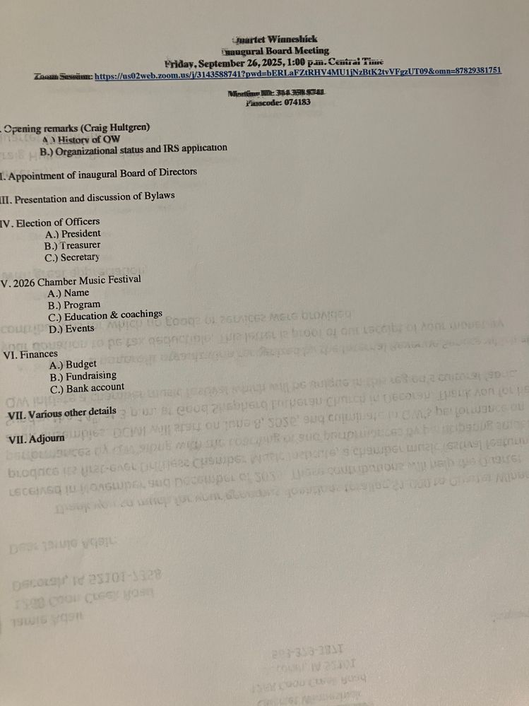

When I attempt to manually align the printer head, no values ever appear on the LCD of the machine, only questions to print patterns ever appear over and over. I have followed the online instructions and cannot get past this. I have attached a photo of the print pattern.

Greetings ,
Please ensure the encoder timing strip is not smeared or dirty.
https://support.usa.canon.com/kb/s/article/ART180548
Can you please confirm you you using Canon brand CL and PG Inks.

Greetings,
Are these the steps you're following?
Aligning the Print Head Manually from the Operation Panel - TR7020 https://share.google/ePbpNt02jTEEzz9AJ

I have followed the steps for aligning the print head manually, and have gone through the process twice. However, I believe the misalignment issue remains. I attach a copy of a printed page that reveals the problem.

Greetings ,

It turned out to be a bad black ink cartridge. Thanks for your assistance.
