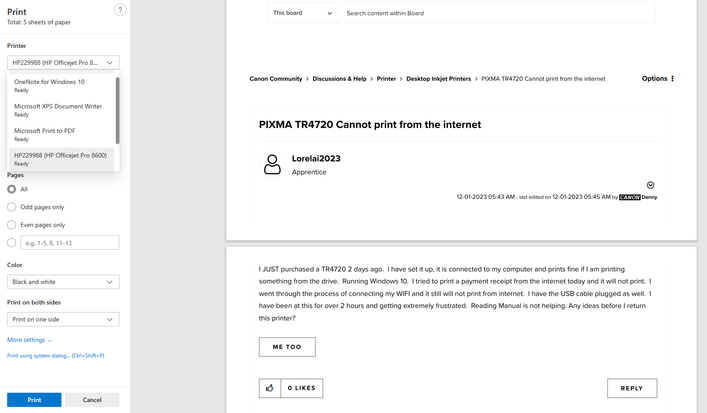

Greetings,
A printer (any) will happily print whatever is on your screen. It doesn't care if its a file on your computer or the image of a receipt displaying on a webpage.
Are you trying to print a file (example .pdf or .docx) or the image of a receipt displaying on a website?
Once the file is open or displaying, press ctrl+p. A print dialog will appear. Ensure your printer is selected as the destination. In this example, I am printing the community webpage of your post. If it were a receipt, it would print that.
