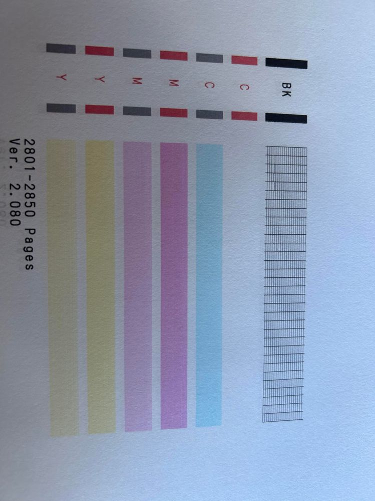

great little printer is refusing to print in blue - so much read
have gone through all the suggestions any help greatly appreciated
done the deep clean, nozzle clean - taken the ink out put it back in
on check the top line C is completely empty
the second line C is sold and light blue the magenta and yellow look fine
black is fine -

Canon cartridge or third party?
03-18-2026 09:55 AM
There are two cyan nozzles, one seems to be clogged, did you deep clean the nozzles?
03-18-2026 07:36 PM
Several times but no change : (
03-18-2026 07:37 PM
it is third party but I've used it before no issues
03-18-2026 08:24 PM
As an MG3620 owner, I think and hope I am right, your color cartridge has one ink chamber either empty or defective, in other words it needs to be replaced.
03-19-2026 01:39 PM
thank you, I fear you are correct : (
