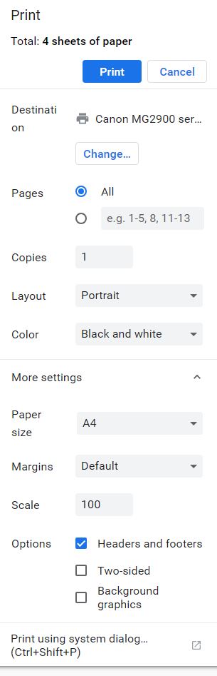

01-24-2019 03:40 AM - edited 01-24-2019 03:42 AM
I just had the problem and seem to have fixed it after a lot of mucking around.
I double checked all the other settings in properties and set everything to A4,set it to Default and changed everytthing again
to how I wanted it so back to A4.
Originally I couldn't get part of the bottom and then it increases to missing the last couple of lines.
Then went to print and checked the More Settings and it had gone back to letter size again,(so changed it to A4 and ticked Fit
to page and printed the WHOLE page succecfully).

Yes only when I go to print on an A4 size sheet of paper.
I only refer to the actual printer properties that I access via the Cannon quick menu:
The links give you their easy access menu's to set things up:
https://ugp01.c-ij.com/ij/webmanual/PrinterDriver/W/MG2900%20series/1.0/EN/PPG/dg-c_fit.html
https://ugp01.c-ij.com/ij/webmanual/Manual/W/MG2900%20series/EN/CNT/cnt_print01.html
https://ugp01.c-ij.com/ij/webmanual/PrinterDriver/W/MG2900%20series/1.0/EN/PPG/dg-print2.html
When I went to print it was near the bottom in the left hand side where the print monologue came up,(that monologue does
change when printing from different websites as the last one I printed from also had the fit to page)
