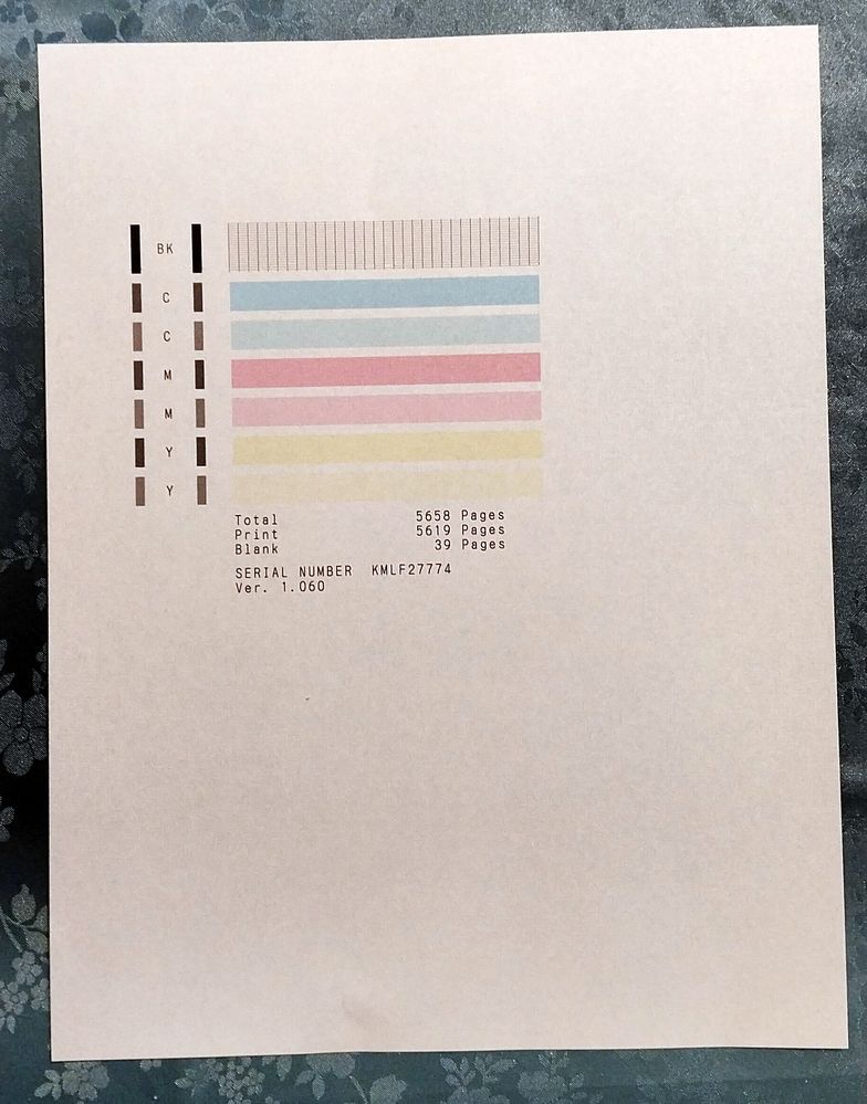

With your G7020 powered on and plain paper loaded in the cassette, please follow these steps:
1.  Please press the wrench and screwdriver button on your PIXMA G7020 one time.
2.  Repeatedly press the right arrow button to select Maintenance and press the OK button.
3.  Press OK on Nozzle check.
A test page will print.
Please take a picture of the page that just printed and then please attach it to your reply of this post.
It is attached. The photo makes the pattern look a bit brownish, and darker. In real life the pattern has no appreciable browning of the black lines, and the bottom yellow is so light, it is barely visible.
In the interim since writing this, I tried manually adjusting the color intensity and contrast, and that helped a little, but it still is not great like it used to be.nozzlecheck.jpgnozzlecheck.jpg

Hi jbjorck,
It appears that the cause of the printing issue that you are experiencing is that yellow is not printing as it should.  The bottom yellow bar is too faded.
Because performing multiple cleanings, including ink flush, did not get your G7020 to print correctly, it would appear that it would require service.
The issue could be with the printhead.  If you choose to replace the color printhead, they can be purchased using THIS LINK.  Please note, there are no returns on parts purchased and no guarantee that replacing the printhead would resolve this issue.
